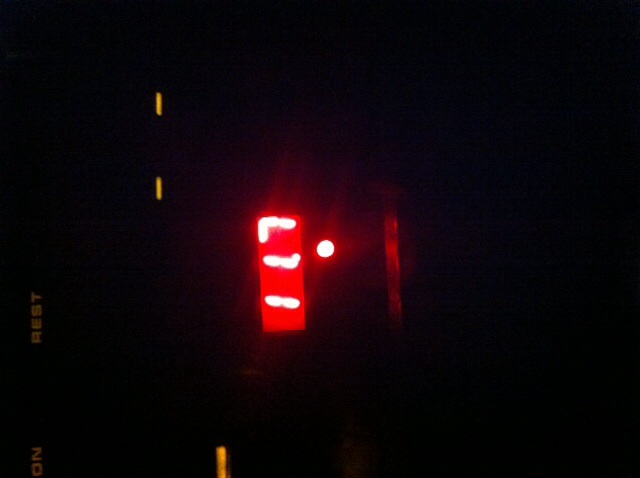

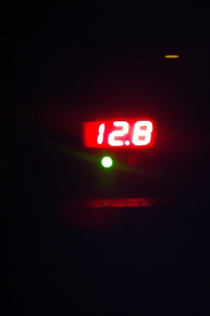

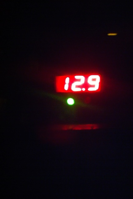

I used this small meter to messure power.
It was showing 11.7
After engine run for some time, higher rev and battery warning sign in the display.
I played with rev a little bit and felt with higher rev the meter showed 12.5 .
Decided to risk to drive home using the highway.
During the drive and rpm between 3 and 4000 the meter showed 12.7 to 13
When i arrived home and engine off the meter went down to
11.7
Tomorrow i will try to do something to find what is going on.

With my small knowlegde i believe this is not a problem of a drain in the system, the new alternator is producing power but the batterie is not charging. I am right?
No, your alternator is not producing enough voltage. It should be between 13.5v to 14.5v whenever the engine is running. I think you need to take the car back to them and demand they fix the alternator (again). All work from Porsche dealer should come with some warranty.
