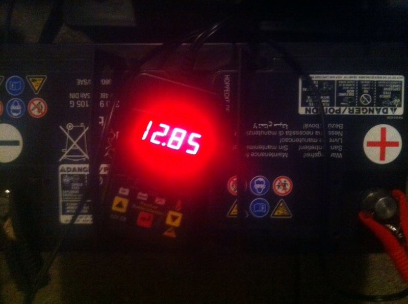

The tester which you recommend didnt arrive today . I used the multimeter on the plus / minus port under the hood.
Yesterday i did a test drive on the highway, car was warmed up. After 30 minutes of driving as i wrote it was almost 14.

Reading on the jumper port under the hood
12, 20
I try to start, of course not working. Readings after several starts
9,65
Used my other car for jump starting. Not working. Starter just make " KLICK"
Changed battery for the new one.
Reading 12,99

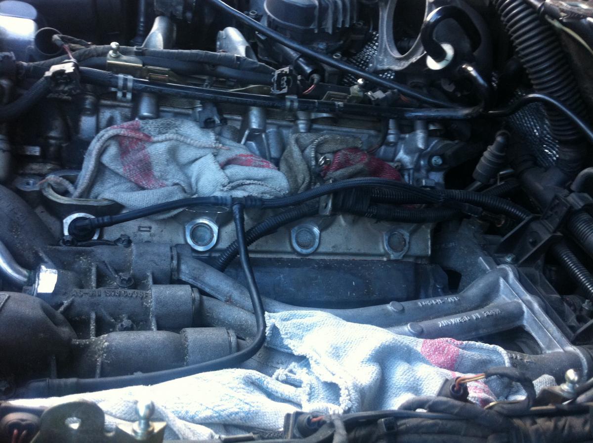

post-77547-0-20711400-1398370783_thumb.j
post-77547-0-49983400-1398370807_thumb.j
