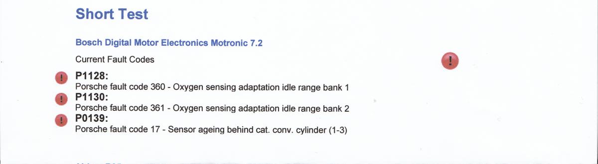

Okay. Been driving My2001 a bit now and CEL came on second time ... Reset when I changed aging battery a month and a half ago. I am suspecting after market exhaust has a bit to do with it. Cleared a while back and just came back after hammering a bit.
Durametrics Codes:post-92415-0-92065600-1392764980_thumb.j
P1128
PORSCHE 360-oxygen sensor adaptation idle range bank 1
P1130
PORSCHE 361-oxygen sensor adaptation idle range bank 2
P0139
PORSCHE 17-Sensor aged behind can conv. cylinder (1-3)
So ... oh great and wonderous knowers of all things Porsche ... give me some input and cures for these, Please! DIY's or Shop ...
Thanks in advance ...
Can you describe a bit about the aftermarket exhaust part? Any exhaust leak? Also check intake leak like at air filler tube, AOS, intake manifold, etc.?
What are the TRA and FRA values on both banks? What are the O2 sensor readings pe-cat and post-cat on both banks look like?
Also, what's the MAF reading at idle fully warmed up with a/c off.

Looks like air leak at intake since it adds more fuel when idling (RKAT) but does not add/subtract much when at load (FRA) where vacuum leak has little effect. MAF reading looks fine.
Can you read the MAF reading in kg/hr instead of voltage? It should be ~17kg/hr @idle and ~50-80kg/hr @3000 rpm.
Do you feel any leak where your cat back system is connected to the cats? Can you remove your oil filler cap with ease but with some suction?
Also agree with Silver you may need a post-cat sensor on bank1 (P0139).

I did some exploring around the the Air intake piping and found the post MAF clamp was very loose. I tightened that down. The clamp at the throttle body was fine. I have driven twice since clearing the codes and no CEL yet. I ordered an 02 Sensor to replace the aging post cat sensor Will monitor and update.
i agree with ahsai, looks like a leak. check your oil filler cap as well. Also, idle should be about 700 rpm and the fact that you are at 780 rpm is another indication of a leak. MAF should be about 1.25 volts with about 17 kg/hr at 700 rpm. Make sure you are reading the mas flow measured by the MAF sensor and not the total mass flow which is calculated.

Replaced both down stream O2 Sensors ... Those codes are gone ... MAF is reading properly at 1.25 and 17kg/hr the other codes have not returned since replacing o2 Sensors ...

I was wondering if P1128 & 30 faultes ever returned since, according to the 7.2 DME technical manual , an aging problem of the down stream o2 sensor (i.e. voltage remians below or above 0.6 volts for 80 seconds) will change the mixture either more rich or lean. I thought perhaps that P0139 was the root cause for all your CEL's. However it sounds like you had two problems. On the otherhand, when your CEL went on all three codes were present simultaneously and an air leak would not casue P0139. So perhaps P0139 was the root.
