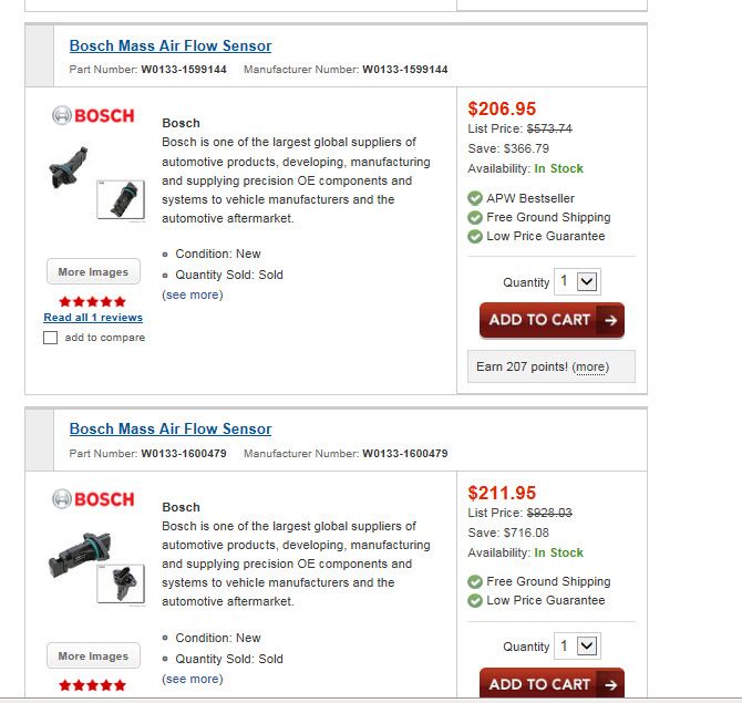

I understand the OEM part costs circa $200, otherwise the Bosch equivalent is circa $60 on Ebay ?
Now the guys at Sportec did a great job on the gasket seals on my Tip but I did think that their proposed price for a new MAF of more than $1,100 was a tad steep, unfortunately I had to decline their offer as had a spare "Der Luftmassenmesser kostet leider sehr viel. Von Porsche 1038.86.- Sfr.
Dieser Sensor ist führ sehr vieles zuständig- ohne diesen oder wenn er defekt ist dann läuft der Porsche nicht mehr einwandfrei"
The Bosch # is 0 280 218 009, Porsche # is 996 606 124 00.
The Bosch MAF is the same as OE for less $$$.
I personally would not buy an Ebay/aftermarket knock-off part.
