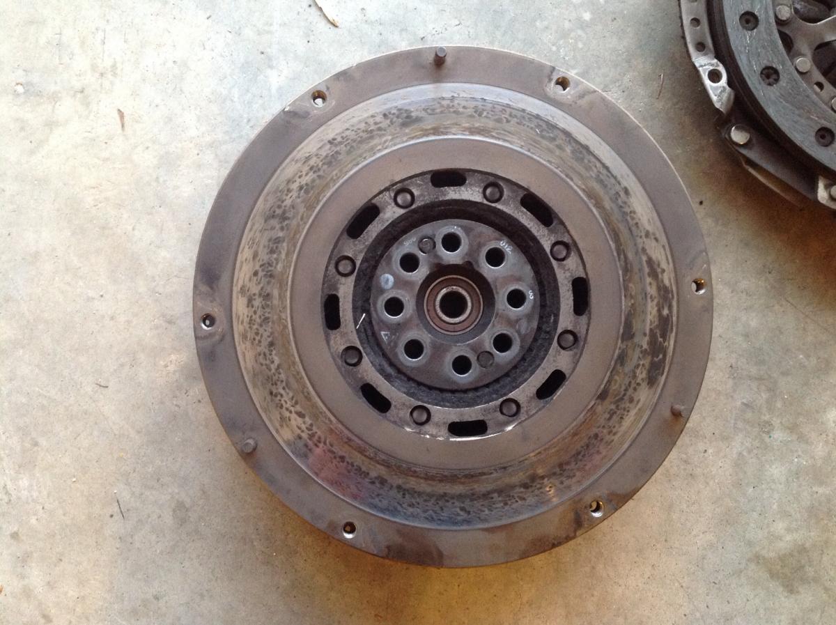

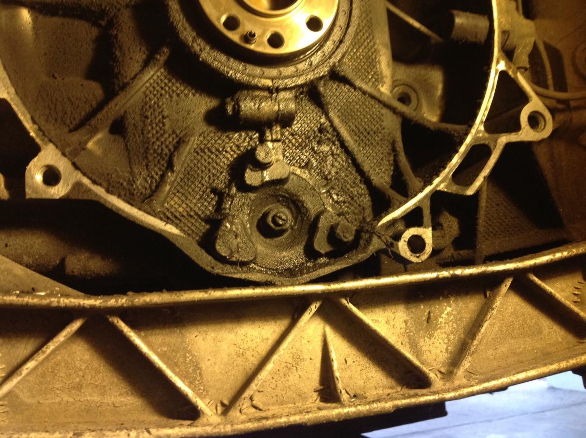

Got the trans out today, and I definitely need a clutch. The $800 question is, "do I need a flywheel, too?" And I definitely need to do the RMS...and now I'm in the whole IMS fracas. Replace or not, and if I replace (almost certainly), which one???
By the way, the job was pretty straightforward until the pressure plate bolts. The previous mechanic had f-ed up the Allen holes, so I had to slot them with a die grinder then use this flat bit screwdriver socket on an impact wrench. Nothing as fun as a die grinder in a tight space!

Just for comparison, I got my 986 @ 60k miles and replaced the clutch (original) at 142k. That clutch was still ok, but I was having the 2nd gear pop out and need a trans rebuild. Got my 996 C4 @ 50k, and now at 75k I'm doing the clutch...and it looks like it was done before.
When I did the 986, theRMS looked good, and I figured if the IMS had lasted this long, that I'd let it go. She's at 166k now and looking forward to another season of racing!!

OK, this will help you with testing the dual mass: http://www.pelicanparts.com/techarticles/Boxster_Tech/44-TRANS-Clutch/DualFlywheelTechBulletin.pdf Even if it passes the "twist test", you still need to look at the surface for unevenness or severe pitting; remember that the dual mass cannot be resurfaced, so if it fails twist or looks like the Moon, time for a new unit.
I would not hesitate to replace the IMS with the LN dual row (your 1999 should be a factory dual row), not all that expensive and you will sleep a lot better once it is in. Also a major plus at sale time......
