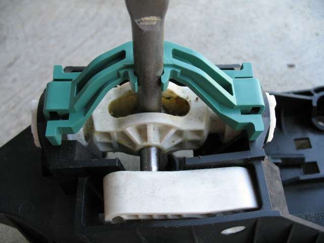

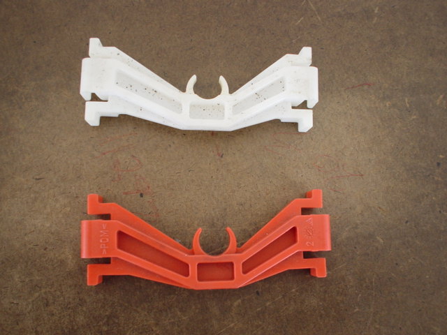

Those are the standard shifter tools.
If you have a short shifter (either OEM or B&M) you will need the special one for the short shifter as it has a larger shaft.

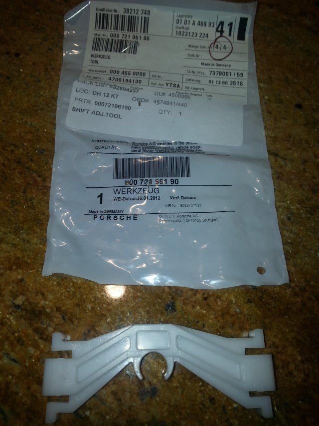

Loren do you have theP/N for the short shifter tool?
Just checked with Phil at Sunset.
The green tool ending in 91 (00-721-961-91) is the tool for the short shifter.
The white or orange tool ending in 90 (000-721-961-90) is the tool for the standard shifter.

I ordered the green tool (00-721-961-91) - $3.13 plus shipping to check and will post once I can confirm.

Sorry to resurrect an old post but does anyone know where I can get a 000-721-961-90 from it seems Porsche discontinued it no one has stock and only the 997 one is available, is 000-721-961-91 compatible with the 996 Standard shifter?
