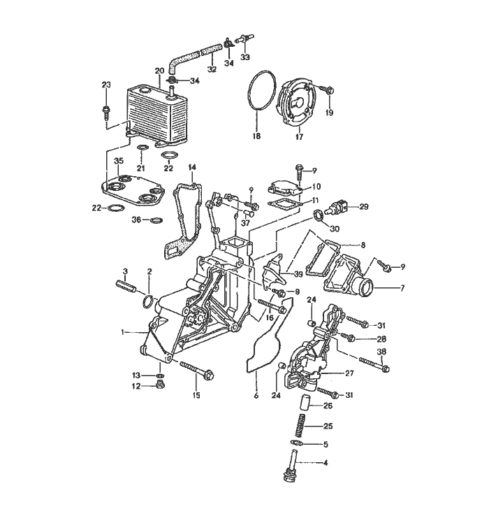

Only thing that I can think of off hand is the oil pump's pressure regulating spring and valve; some M96 cars have had issues with the spring and have had to replace it. Items #5, 25, and 26 below:
Cheers JFP, but already replaced, with no luck.
