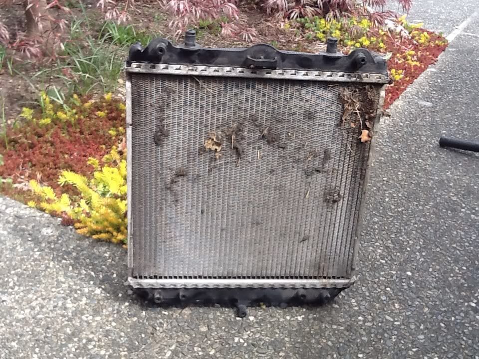

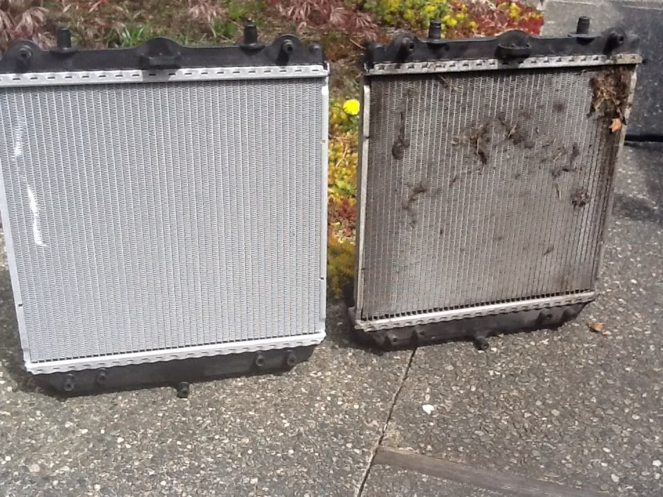

Here is a photo of my old radiator and the new replacement radiator.

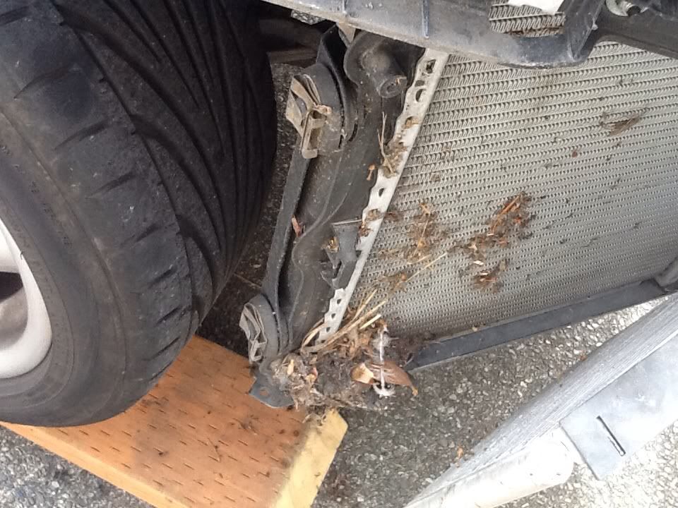

And a shot of the radiator and condenser prior to cleaning. You'll be surprised what you'll find. The last time I had a small rodent in there.
