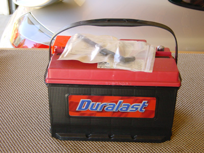

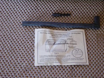

My new battery has an oval vent, smack in the middle side of the top of the battery between the two posts. I had to gently squish the angled tube at the end of the clear plastic tubing to fit into the oval vent, but usually these vents are round and are located at the narrow ends of batteries at the top.
The vendor that you bought the battery from should have given you the vent tube conversion kit. It converts the oval tube outlet to the round tube on the car.

Yes, same issue with this type of battery vent - they need to supply you the vent kit.
In this case the battery has a vent hole on each side. In the vent kit is a connector and a plug. You simply plug connector to the battery and then your vent tube and plug the other side of the battery.
