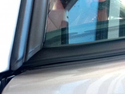

I've had a problem of wet carpet on the door. The membrane is in tact. I suspect that after replacing the regulator, the window is not going up as far as it should when the door is shut.
If there's anybody with a 2003 986 who wouldn't mind comparing the position of their window when closed with the attached photo of mine, I'd be very grateful.

From my experience with the window regulator changes on my boxster, the window can be adjusted backwards or forward. Check your window bracket positions on the regulator .
