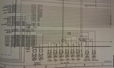

Now if someone can get me a wiring diagram so I can test at the dme and see if I have a short or a bad DME.

Sounds like you lost the DME control side (violet wire either stuck to +ve or -ve). The valveis at the bottom right of the diagram below. See "Valve tank venting". The ground side is connected to pin 61 on the DME and pin 9 on the X59/1 engine harness connector. The engine died when you activated the valve with a 100% duty cycle (continuous power to the valve) is probably because of too much fuel (vapor) got sucked into the engine beyond what the DME can compensate for.
I think using LED with a resistor is safer than a noid light which is designed to test higher current output like fuel injectors. I think this valve is only using very low current so you MAY overload the DME by using a noid light to replace the valve.
