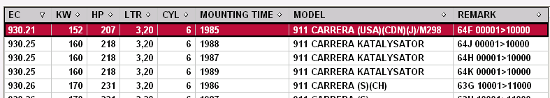

wow - quick repsonse , many thanks ! Sorry, it was a 1985 911 Carrera. My research on the VIN shows it was imported from the states (i am in Australia), but it appears to be not the original motor - but I am a novice ! I understand from my research that the last four numbers of the VIN should match the last four of the engine number. The VIN is WP0AB0917FS121230 so it looks like the motor is from a very similar model, but not the original one. Would that be correct?

Here is the information associated with the VIN you posted. Hope this helps you out.
DC
DC
thank you DC - so this confirms that it is not the original engine - would that be correct? (sorry if its a dumb question !!)

No that shows it is a 1985 car with a 1985 engine.
Only Porsche repair records (or certificate of authenticity) for this car could tell if it is the original engine serial number.
