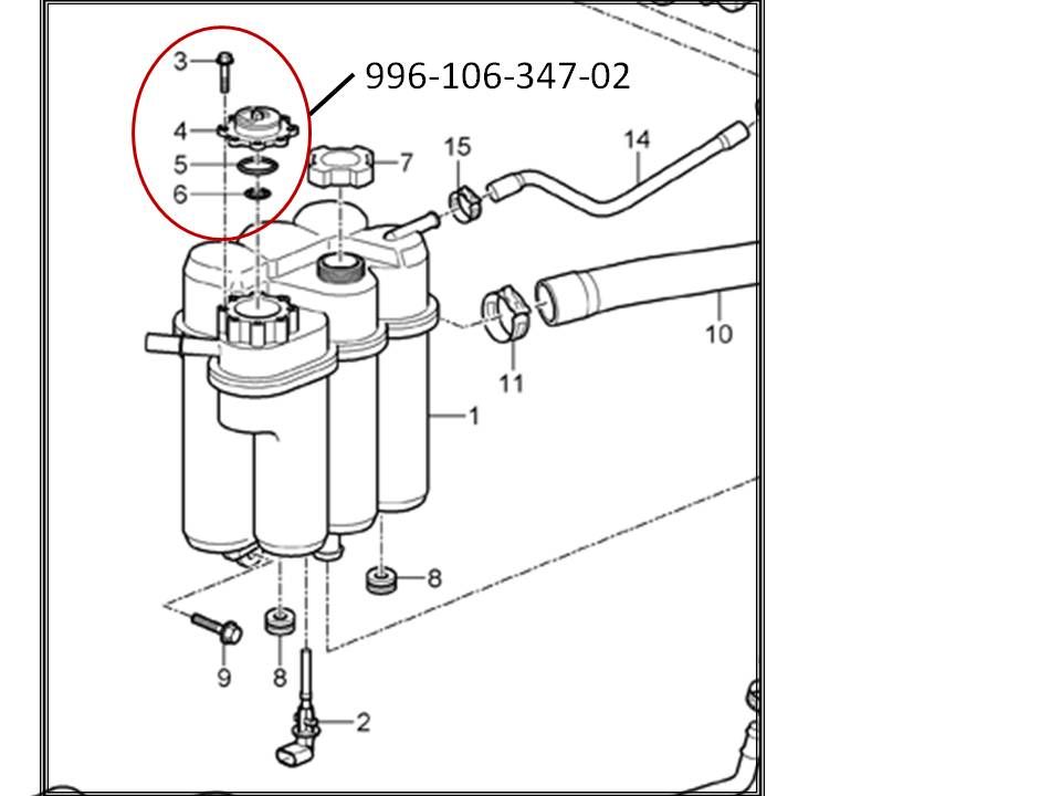

It is not uncommon to have a faulty bleeder valve.  Part number 996.106.347.02.   Fits 986, early Cayman and some Carrera's.  Cayman photo shown.  You would need the entire kit, comes with 8 hexagon-head bolts (part #3 in photo).
Word of caution these bolts strip easily so don't over tighten. The bolts don't strip the plastic they screw in to does.  Priced recently at Sunset for about $75.  Easy DIY.

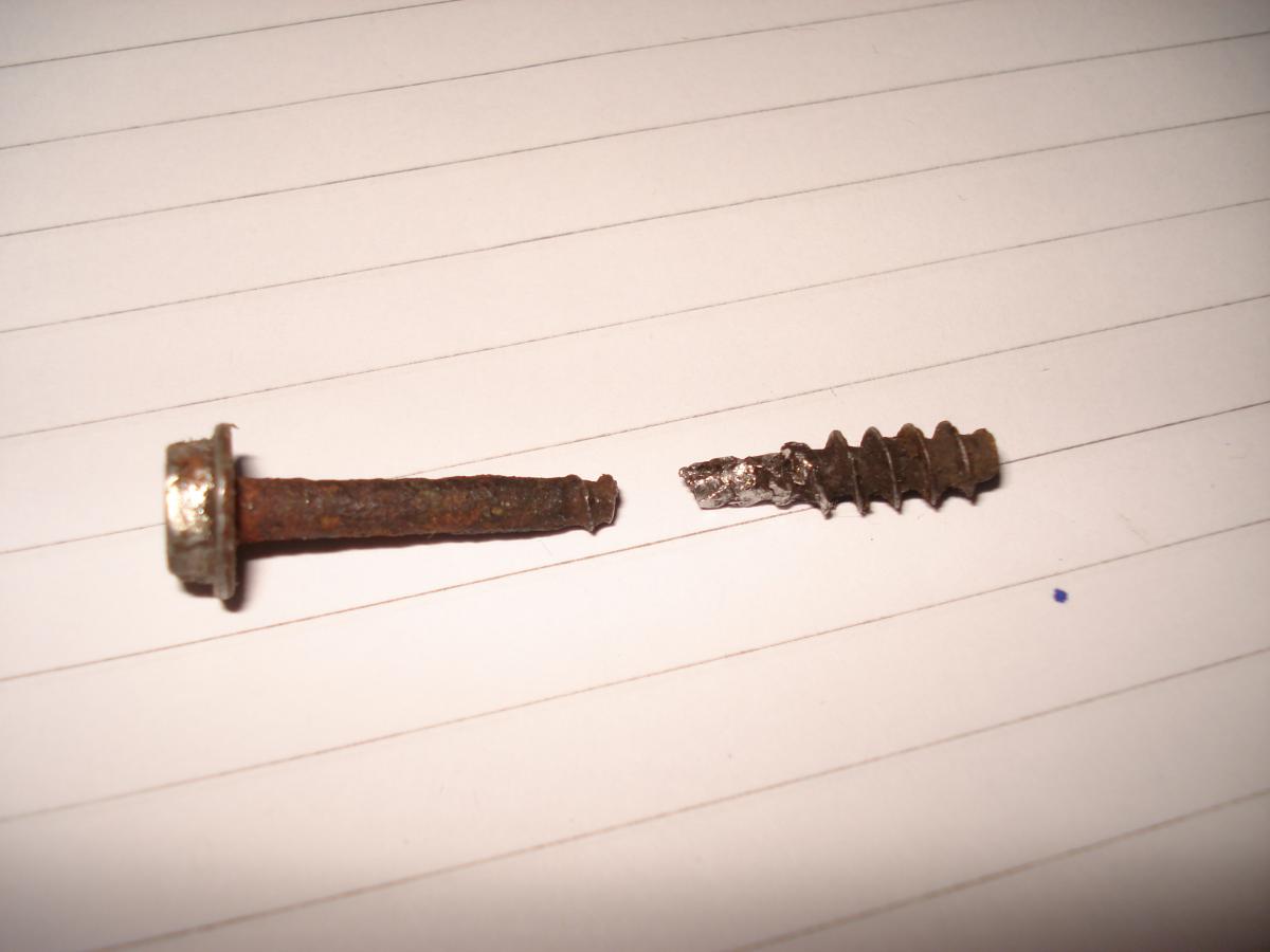

I was having coolant loss before replacing my header tank. It was leaking from the gasket between the relief valve housing and the tank as one of the screws had corroded. I did a temporary fix with a new screw from a second hand tank.  I replaced the tank with a new one and I was still having leaks until I put a new tank cap on.
