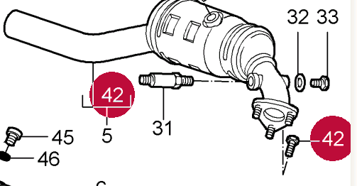

900 075 365 02 M8 x 30 screw -- US MSRP $3.44 each
I suggest new gasket(s) and nut(s).
997 111 113 00 Gasket -- US MSRP $6.90 each
999 084 052 02 Nut -- US MSRP $4.52 each
Correct. So they are screws and should be extractable from the cat side of the flange ? Any reason not to use upgraded SS blots and nuts ? Will a high quality antiseize hold up to the heat over time to be of any use ?

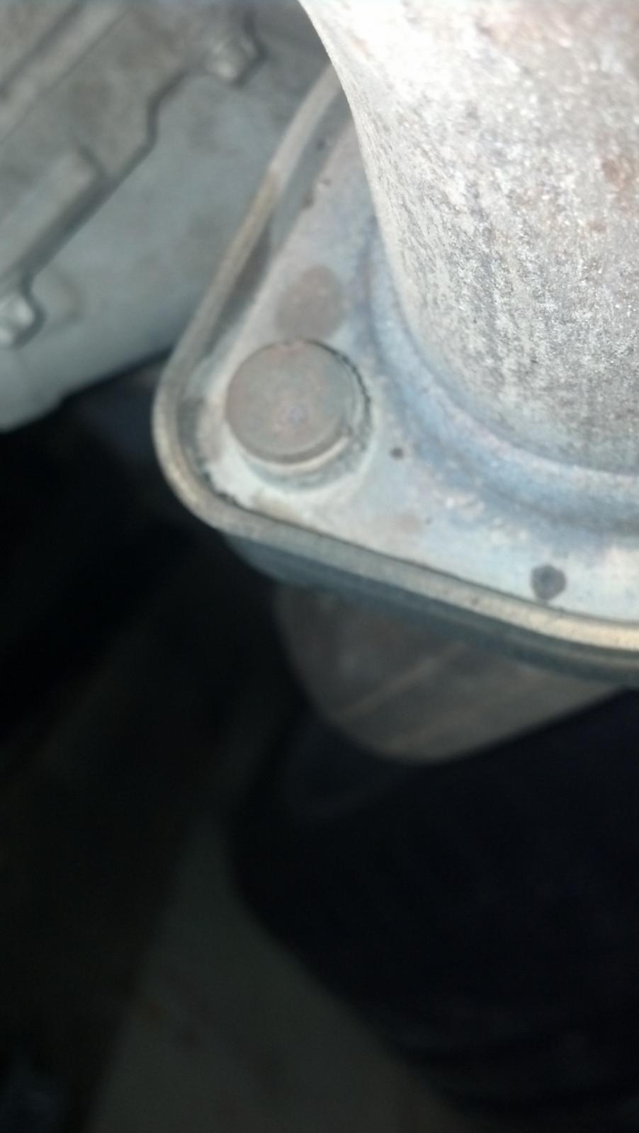

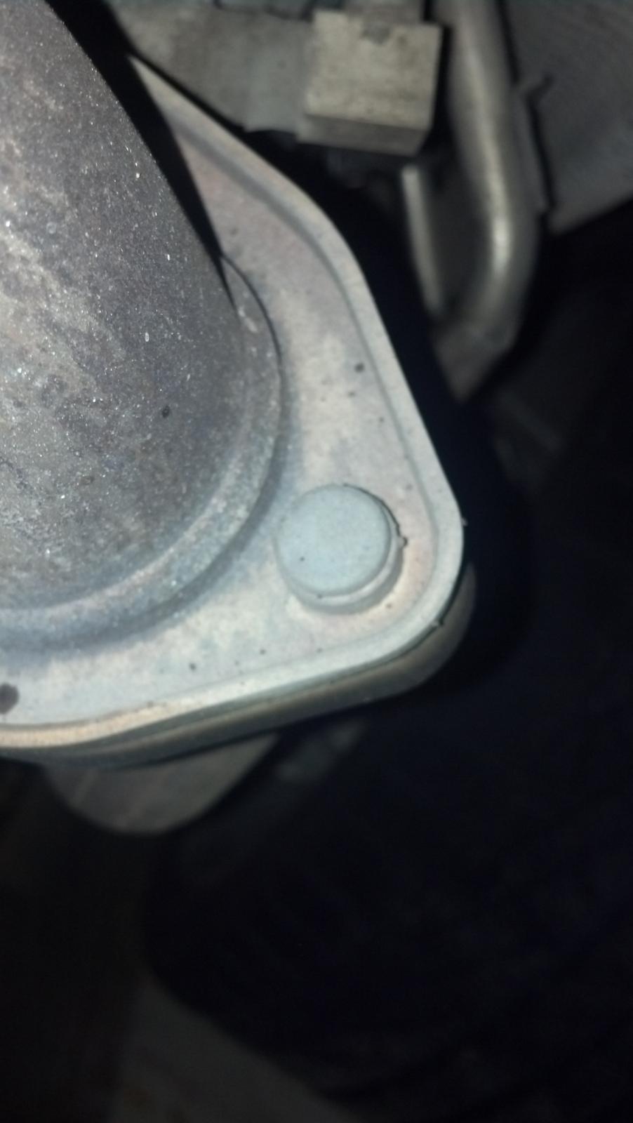

As an update to my original post, finally decided to get under the car and inspect the flange bolts, or better put, studs and they are indeed what look to be pressed in studs. They are not hex head screws as I was hoping. see pics... I know what the PET shows but that must be for replacements. The originals are pressed in studs. So any suggestions for the DIY'er or do I take the cats off and have all the studs pressed out ? Anyone ever try drilling these out ? don't have access to a torch so that's not an option.

By "tapping " you mean mild pounding or the "hammers of hell" type pounding . Will soaking with PBLaster assist in the removal process ? Any reason the be concerned that the vibrations from the "tapping" will have any negative impact on the O2 sensors given their close proximity?
Sorry for all the questions put my brain works best when it isn't questioning what my hands are doing .
When I was changing out my cats to go with a 200-cell X-pipe I knew some of those studs were going to snap. They just look flimsy. I should of soaked them with some PB prior to trying to remove them but I figured that I did not really need them either way. I ended up snapping 3 out of the 6 flange bolts.... I would of probably drilled it out and came through from the other end if I was in your shoes.... I would go ahead and PB blast the 2 other nuts, remove them and the whole cat section to be able to work on it from a work bench.
