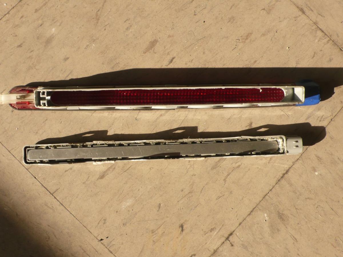

Y2K, Thanks for the follow up... Yes, I realize that so far no one has made our wide body tail lights. Anyway at this time I'm only interested in the 3rd brake light. What I'm going to do is to install a red LED strip in my 3rd tail light and see how that goes.
I gutted the light bulb receptacle and then took a die grinder to the light strip to make one continuous opening. Then cut and fitted a piece of .030" aluminum and attached it with JB Weld.The LED strip has an adhesive back.

What I did do is to gut the brake light housing, see above and installed a red LED strip. Just today I got it wired up, LED's are polarity sensitive, the red LED really pops. I think it's a cheap way to tell the guy behind you that your stopping. I'll get a pix with the brake lights on in the
dark and post ASAP.

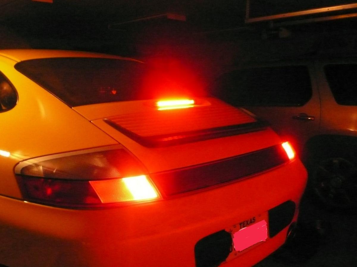

Here's a pix showing the 3rd LED brake light, it's a lot brighter than the tail light brake light. Just remember that the LED is polarity sensitive.

Why not just replace the OEM bulbs with LED ones in the 3rd brake light?
That was my first thought too, but to do both strips (wing light, top light) its about $85.
Creekman - did you use the available adapter or just solder to strip directly?
Yes, and to do both lights (14 Bulbs) is about $85.
Which is about the same price as an entire interior set. Think I might try the LED strip route
