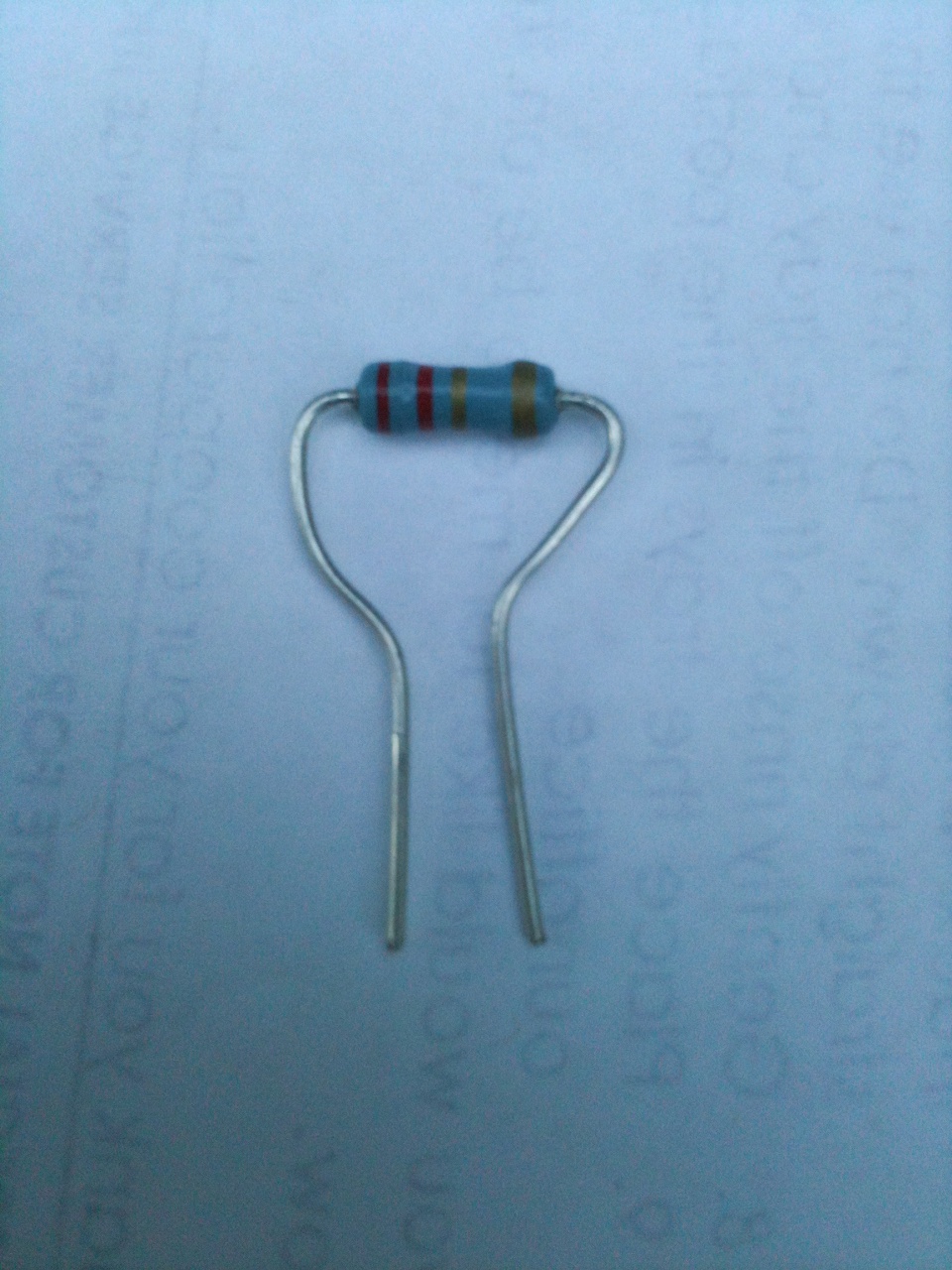

Loren is correct the only way to turn off the light use a resister and jump the pins or put the seat back in. you will also need Durametric, a Porsche PST2 or Porsche PIWIS to clear the airbag code. We use a 2.5 ohm resister as a simulator to test SRS systems all the time. You can find tool companys that sell SRS simulators with the yellow plug but youre going to pay $75.00 to $100.00 for it. If you get a resister just shape it like the picture and jump the pins.
post-29211-0-55437800-1380503828_thumb.j
Edited by binger
I would gladly pay $75 to $100 for a simulator. I am not comfortable making my own resistor and jumping pins. Can you please link me to any tools that are for sale for this purpose?
