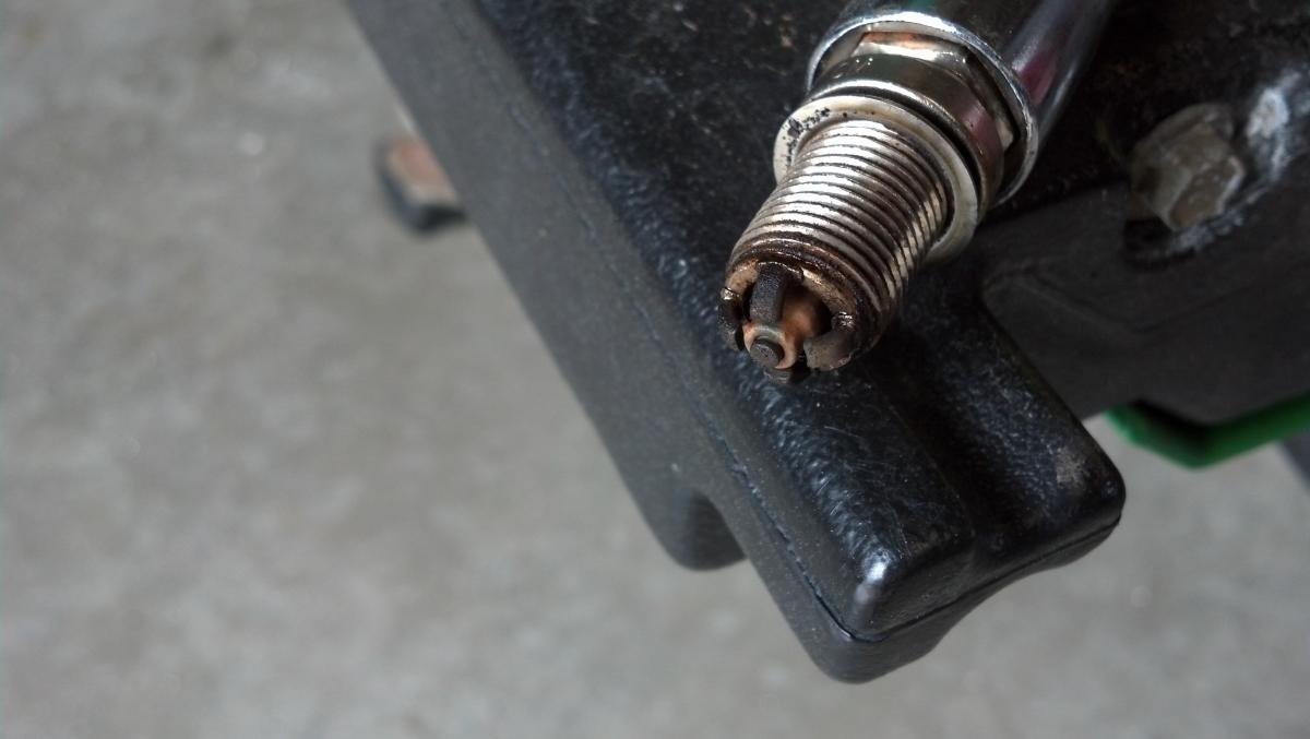

Still chasing that misfire! Must be the plug...
I swapped the coil out for a new one last night, (just had a few spare minutes to work on the car...)
Still misfiring on cyl 2. I checked all the rest of the cylinders, and they were fine. Just cylinder 2..
I intentionally did not pull the spark plug, becasue I am trying a systematic approach to eliminating the real problem. Tonight I will pull the plug and replace. When I isolate the problem, I will replace all of the coils and plugs.
__________________
When you pull the plug on the bad cylinder, take note of its color and level of carbon build up versus the other plugs, this will help give you a better idea why it is acting up.
Thanks for all the help! It was the #2 plug. I have included a pic. I also changed #3 to get a look at the plug. It looked much better...
Runs great now... no codes or misfires. Thanks again for your help!
