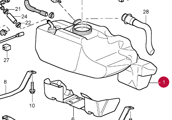

I took a 3/8" I.D. hose down the fill pipe, I was only able to siphon about 2 gallons of gas, then it started to suck air. The hose wouldn't go down any further... I can't believe there's no way to drain the tank short of removing it.
I guess you could remove the battery and the top cover to the gas tank expose the fuel pump in the tank to get at the gas? Am I correct? Just seems like there should be an easier way...

Thanks Loren for your reply. I think you're saying that there's no way a siphon hose can get into the "saddle bags" of the tank. HOwever in my case the gas tank was full and I was only able to extract about 2 gallons. I'm going to try a smaller diameter hose to see if I can get further down into the tank.
I tried a 3/8" O.D. hose and wasn't able to get it any further down the fill pipe than the larger hose. I've showed a sample of the gas to several knowledgeable people and they both agreed
the gas wasn't that bad. It's not good, but since the gas isn't coming out I guess I'll just run the gas out ASAP.
