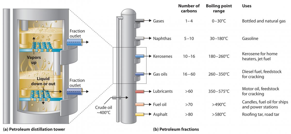

  On 10/7/2013 at 1:49 AM, Mijostyn said:
Jl-c, water condensation may boil off because water molecules are polar. Fuel and oil are both non polar hydrocarbons. Once fuel is dissolved in the oil it will not boil off and the drop in viscosity is permanent.
I don't agree with this statement. Gasoline boiling point is 25 - 75*C. It will boil out of oil which is much heavier at about 300-400*C boiling point. It's called fractionation and has nothing to do with polar nature of gases or fluids. That is how gases, gasolines, naphtha, kerosene, oils, etc. are extracted from crude oil. Edited by luxter
Hold on Luke,
You are talking about fractional distillation. Crude oil is vaporized at a temperature of about 1000 F. The vapor then rises in a cooling tower. As the oil vapor cools on the way up the various fractions condense at their boiling points on plates which are piped to various holding tanks. Key point, you have added enough energy, in the form of heat to separate ALL of the crude oil molecules from each other. The separation process occurs as the vapor condenses.
Oil temp in Cars is held at just above water's boiling point of 212 F.... To make sure the oil stays dry. Remember, when you burn any hydrocarbon you get mostly carbon dioxide and ...water. The stuff dripping out of your tail pipe. Although gasoline has a substantially lower boiling point than oil in order to separate the two you have to vaporize the lot and catch the fractions as they condense. This does not happen in a car engine. However, water molecules being polar will boil off as they are repulsed by the non polar oil molecules. Try mixing olive oil in water. You can do it actually if you apply enough agitation to emulsify the mixture. This is what happens when coolant leaks into the oil usually via a blown head gasket. Looks sort of like a chocolate frap. You can still separate the two by just heating up the mixture. The oil will rise to the top. Not an experiment I would care to try. Mix gasoline in oil. The gasoline dissolves instantly. Now heat up the mixture. Does the gasoline float to the top?? This reminds me of those folks burning their house to the ground with a turkey fryer.
Edited by Mijostyn

Nice picture Luxter, it pretty much explains things but does not give you an idea of the scale. These towers are HUGE. Not exact sure but they are at least 4 stories tall.
The nickel levels are false. Something about the nano particles screws up the test that Polaris uses. Harry and I both talked to Millers and it is absolutely nothing to worry about. All our other wear metals are excellent. I change the oil 6000 miles because of the falling TBN and fuel dilution. The CSF 5W40 starts out a bit thicker than Mobil 0W40 to start. By the time my oil is diluted 3% it has probably dropped to the viscosity of the Mobil. Some how I get the feeling that some of the problems with cylinders scoring and bearings failing may be due to this. People running their oil out to 10,000 miles may reach up to 5% dilution if their engine is like mine and there must be quite a few. That is more than enough to drop the oils viscosity one whole grade. But also the oil's lubricity drops. It does not reduce friction as well. The CSF nano oils also have a lot more ZDDP in them which helps cut friction quite a bit. I have to say my engine runs like a top and is smooth as silk. The only issue with the Millers is the price.

I've been in oil and gas for last 20 years, so happen to see, climb, inspect, etc. these towers. Stinky business.

I'm not sure I can agree with your comments on fuel dilution.  Nearly all the components in gas have considerably higher vapor pressures than water, so if the water is boiling off, the fuel should have preceded it.  I think the issue may be how (the analytical technique) your UOA lab is measuring fuel dilution, they may be seeing accumulating fuel additive's that remain after the fuel actually flashed off, which would give the impression of increasing fuel dilution with time.
It has nothing to do with vapor pressure JFP. It has to do with solubility and the polarity of the various molecules. I discussed this before when I explained fractional distillation. This is a mistake many people make. The UOAs are quite predictible in this reguard and reasonably accurate. Fuel does not boil off once it is desolved in oil. In order to separate it you have to heat it all up to 1000 degrees and catch the molecules as they condense. This is how oil refineries work. Non polar molecules attract each other in solution but repell polar molecules such as water. This is why the water boils off.
I am going to have to look into this subject a bit deeper; I am find many references to the fuel dilution flashing off when an engine reaches both full operating temperatures, and some level of vacuum in the sump, and nothing (yet) to support your point.  We will come back to this topic.................
It is funny how we develop these mythologies. Humans are funny creatures. When we do not know what is going on we make stuff up! Then the made up stuff gets a life and away we go. A good example is the gluten fad. I have to deal with this stuff every day. Most of the myths have some basis in reality. All substances have a vapor pressure which varies based on the nature of the substance and temperature. The molecules in gas as a conglomerate have a higher vapor pressure than the conglomerate molecules in motor oil. But, when you put them in solution together all bets are off. Think of it this way. Is the vapor in your crank case near as explosive as the vapor in a gas can. It does not take much gas vapor to cause quite the explosion!
