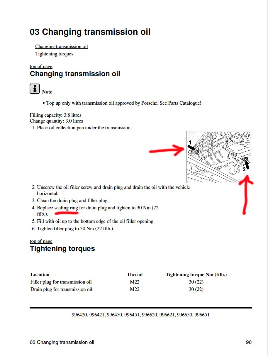

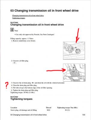

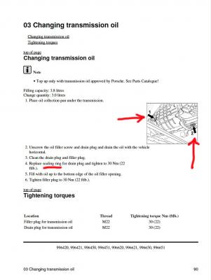

Before I start I would like to know if I got all the parts. Repair manual mention only one o-ring for the drain plug of the manual transmission which is part#900 123 118 30. That mean there are no seals on the fill port???Also there is no mention of any o-rings on the fill or drain port for the front wheel drive and could not see any in the parts catalog? Anybody got any experience with those transmissions servicing? Thanks a lot, J.P.

Correct the manual transmission filling port has no seal other than the plug.
Also correct, no sealing rings on drain or filling ports for the front wheel drive.
