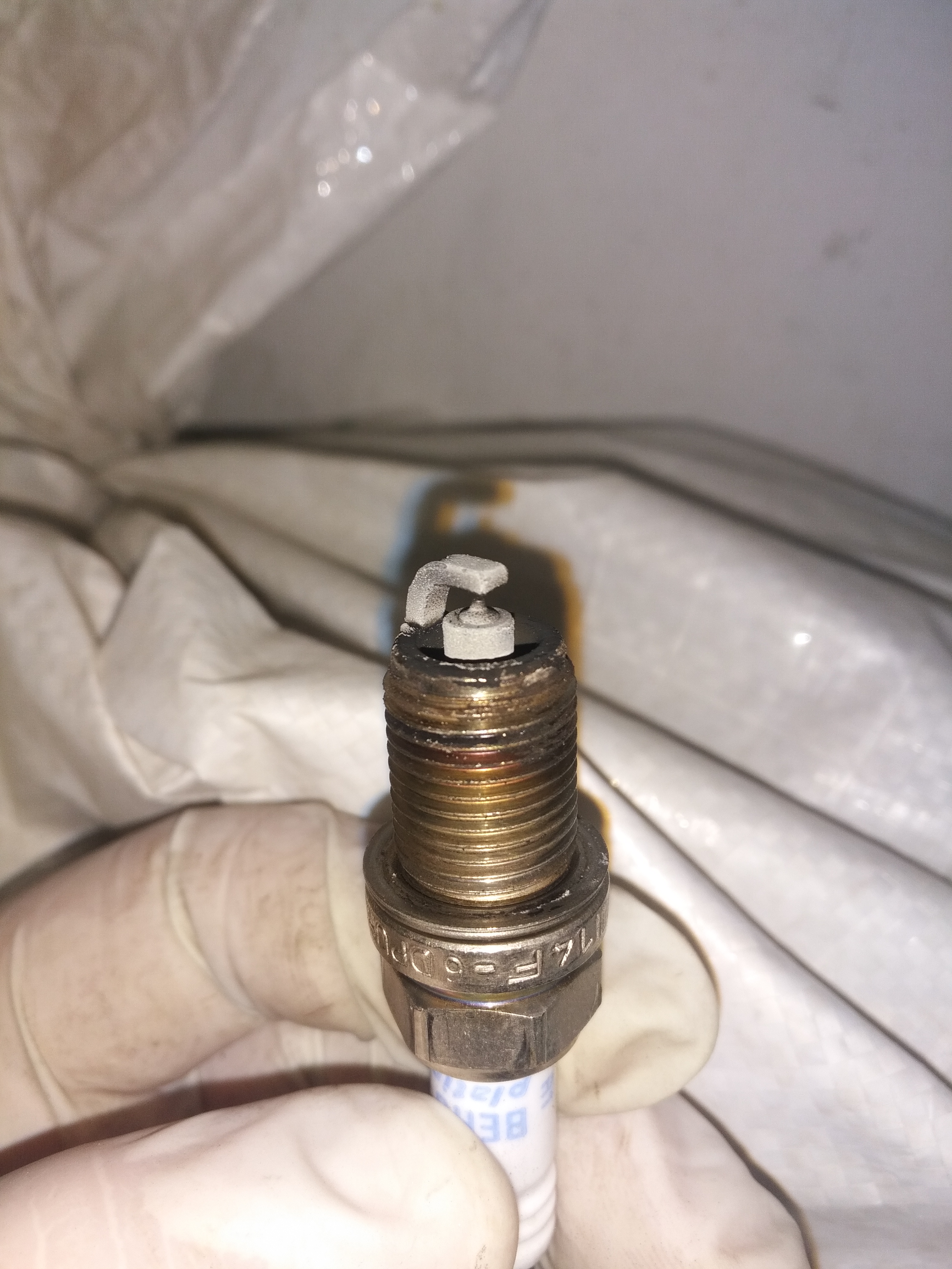

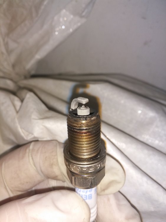

Re-gapped all beru oem platinum plugs to 0.7mm from the spec gap of 0.8mm.
Plugs look OK to me, possibly a bit on the hot lean side?
What I did find was plug from cylinder 1 had three cracks in the ceramic insulator running from top to bottom! The cracked track was dirty so must have been tracking for a while.
(Some people say dropping the plug, over tightening or wrong angle with socket could cause this, but as the crack is blackened I don't think so).
I put in a used plug from before for now until I can go buy a new one.

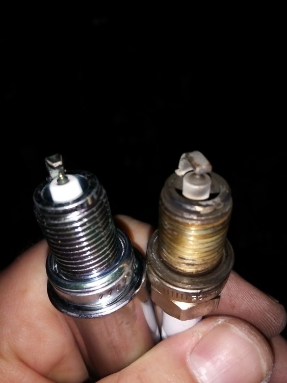

Growing impatient and not liking the look of the cracked plug insulator on cylinder 1 I'm going to replace these Beru plugs with NGK's iridium BKR6EIX or maybe the BKR7 instead one step cooler plug as I'm in middle east and lowest ambient temperature is 16oC and hits 50oC in summer easy.
Pre-Gap spec is 0.8mm (.032") but some tuned turbo's have reduced this to 6.6mm (.026").
As this ctt has the E81 power pack is there any other plug better recommended?
Fitted new ngk BRK7EIX plugs with standard pre-gap 0.75mm.
The ngk just look so much better and more design specific I think, a fine tip and a tampered elctrode strap all designed for max spark and burn pattern, the beru look caveman in contrast.
The results of driving is smoother and more responsiveness. It hasn't magically made the stutter and bucking under boost disappear but wasn't expecting it to, only throttle body resets seems to be able to get the sluggish back after a while of deteriorating driving performance.

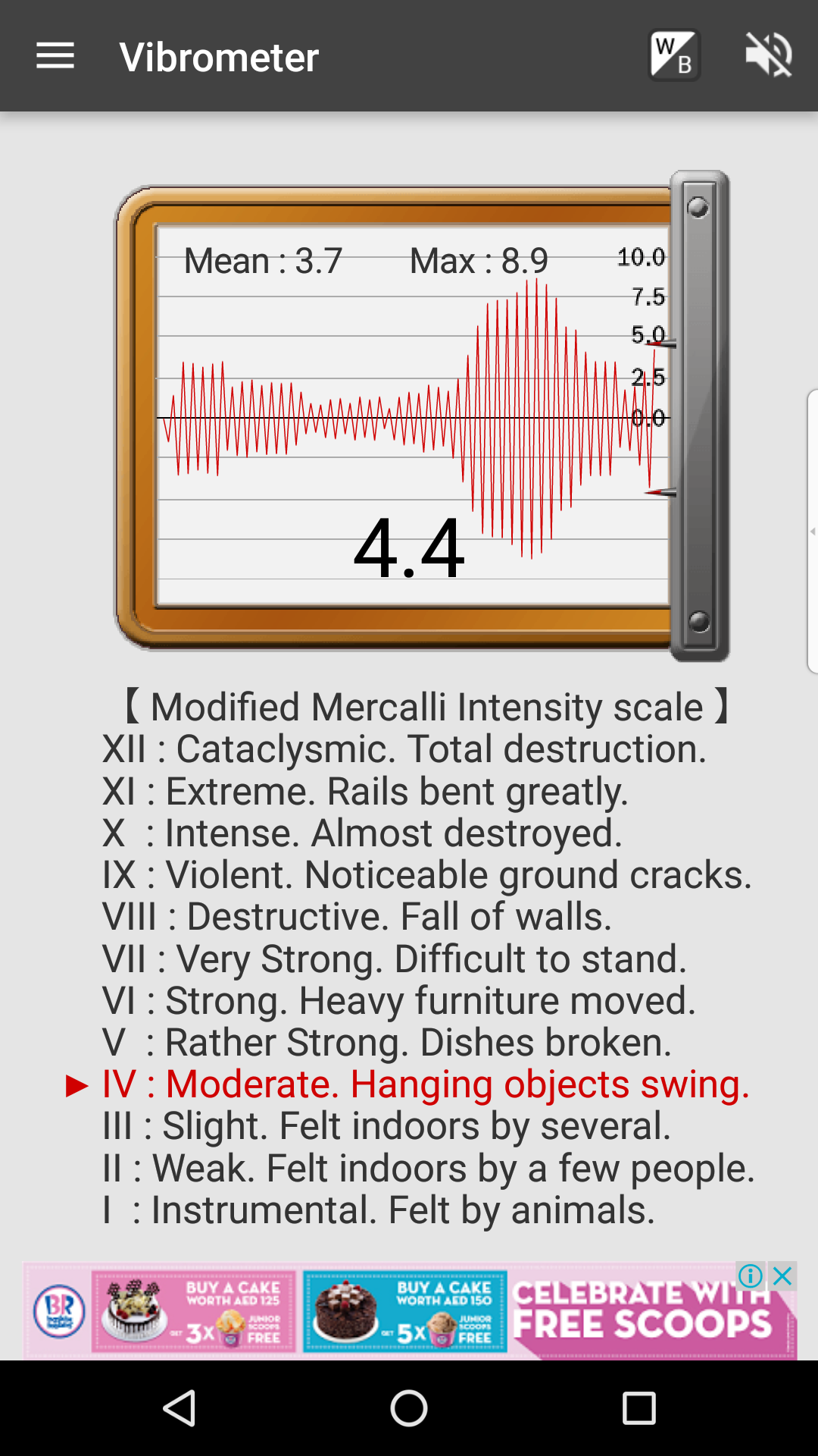

For a bit of fun using a smart phone app called Vibrometer I measured the vibration of the engine (by placing the phone on the intake manifold just behind the throttle body) at cold start just after the "choke" kicks off, it was 4.4 with the 8000km old oem Beru plugs, with the ngk plugs it was 3.8! Make of that what you will.
