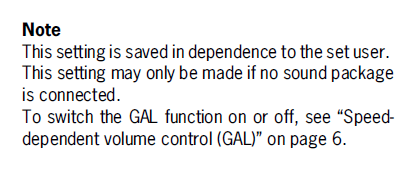

The "GAL" function is set in the radio not with PIWIS.
The setting is only available if there is no sound package installed.
See page 19 of the CDR-23 Owner Manual (if oyu do not have one you can download one here)
