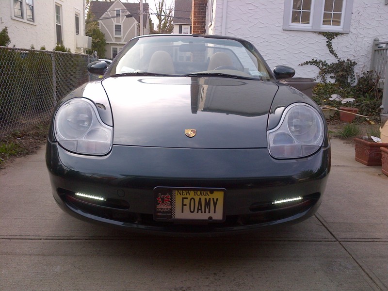

After having very good experiences with the custom dynamics "Tru Flex" weather-proof LED strips in 2-3 other vehicles, I decided to attempt them on the 996. I was looking for a place to mount them that was unusual and also a natural look, as well as make the concealed routing of the wires easy. Here is what I came up with.
Wires are routed underneath the headlight, up through the frunk, into the cabin where I tapped the smartphone outlet for switched power with a 5 amp in-line fuse. Everything is tucked away and shrink-wrapped and no wiring can be seen. I have to seal the strips with silicone, but the job is almost done.

Nice job. What size LEDs did you get?

I got the 12 LED strips. The strips come with double sided tape, and I always use clear silicone to seal the edges.

I used the same LEDs from Custom Dynamics as the OP, but mounted them on Aluminum angle bar (3/4 inch) cut to the length of the LED strips. I painted whatever Aluminum was showing black. I mounted them on the inside of the grill using 3M tape, so that they are recessed. I already had switched power in the trunk from a Laser Diffuser. I really like how they look. The LEDs are really bright and match up with OEM lights I see on newer cars. The only thing I might change is I may bend the aluminum a bit to conform more closely with the curve of the bumper. I'm not sure it's worth the effort as it really does look good. I do have some extra aluminum, so I might experiment.
This image from my phone doesn't do it justice. These LEDs are very bright.
