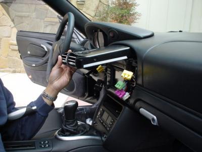

Does #3 snap into place? When I installed my horseshoe, the upper section didn't snap in, and seemed to be a bit loose at the upper middle.
Thanks!
Edited by mffarrell
I think 3 is for when you remove the air vent. I remember sticking in a screwdriver in there.

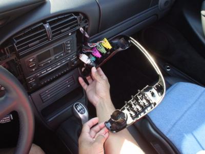

Pull your trim off. If I remember right there are metal clips for the plastic prongs on the back of the trim. Sometimes those clips come out.
Do you remember if there are clips holding the top center section? I don't see any on mine, but it's a bit loose at the top, meaning I could move the plastic trim if I pull on the upper piece. Is it suppose to be that way?
Thanks Tool Pants.
I can't remember what I did yesterday. We have removed that trim on several cars and never a problem. I do make sure the clips, think there is 4, are in place before putting it back on because once in a while they pull out when you pull off the trim.
From looking at this picture there is no clip at the top. So it must be 2 on each side.
Pull it off and put it back on, starting at the top.
