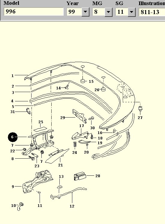

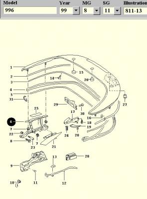

It has to parts, one curved and one straight. The straight one also broke on mine. Unfortunately, Porsche doesn't sell the upper hinge, only the whole piece with the body bracket.
Once I got it home, look at the two hex bolts on the part, and undo them. If you undo them on the car also, no need to replace the body bracket.
Open the top half way to elevate the steel cover, I followed the directions of the SmartTOP to get to the carpet. Used a basketball to hold the metal top cover up while removing and reinstalling the hinge. Not a big deal. Sorry didn't take any pictures.
Izzy
Sunset Imports was extremely helpful with my part search. The part number is 996-561-907-02 and it is primed. As Izzy pointed out, I need the entire part #6 below.
