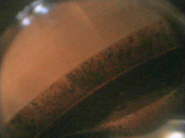

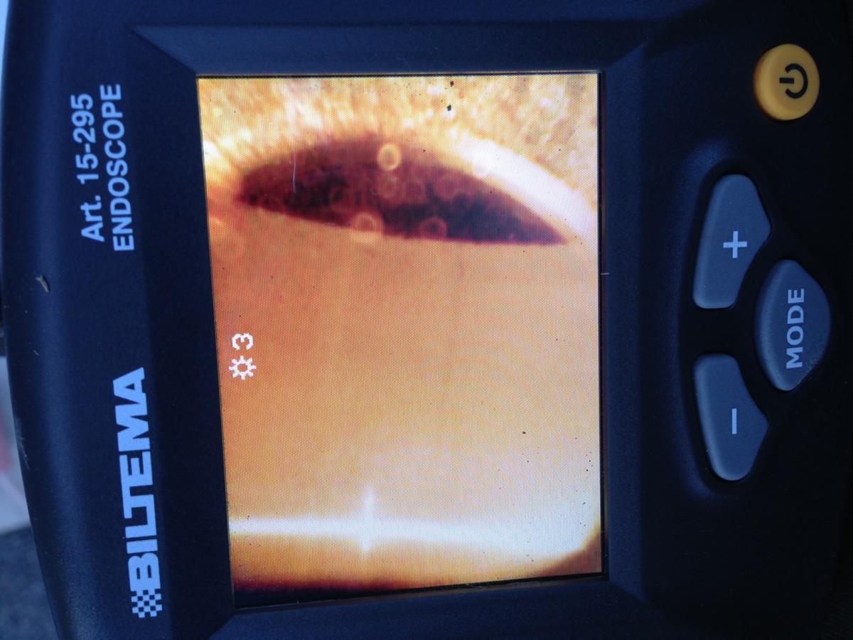

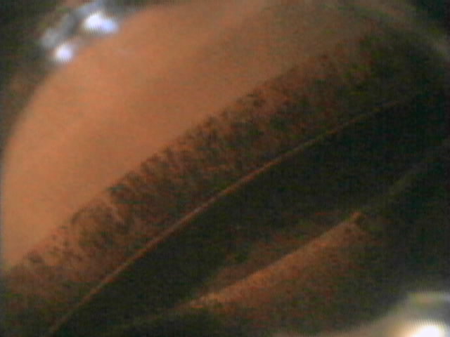

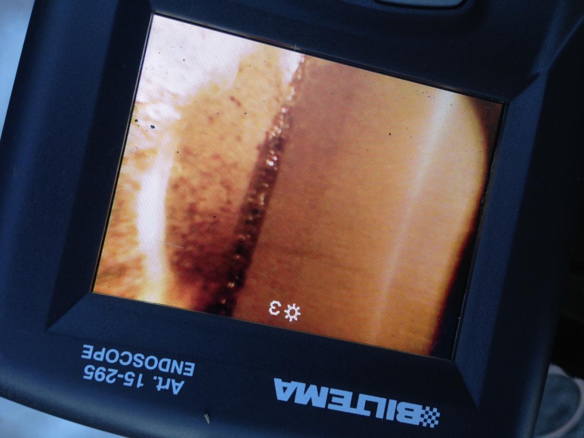

Hi!

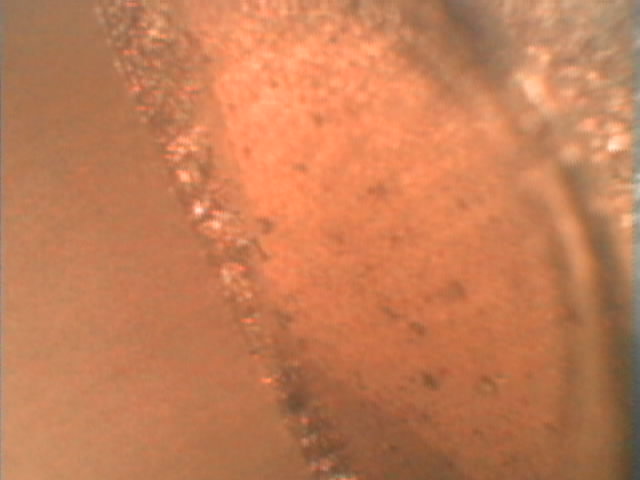

I think I might have a cracked cylinder liner.
I have some pictures taken with a endoscope.
Gratefull for any advise.
1998 996 C2 71,000miles.

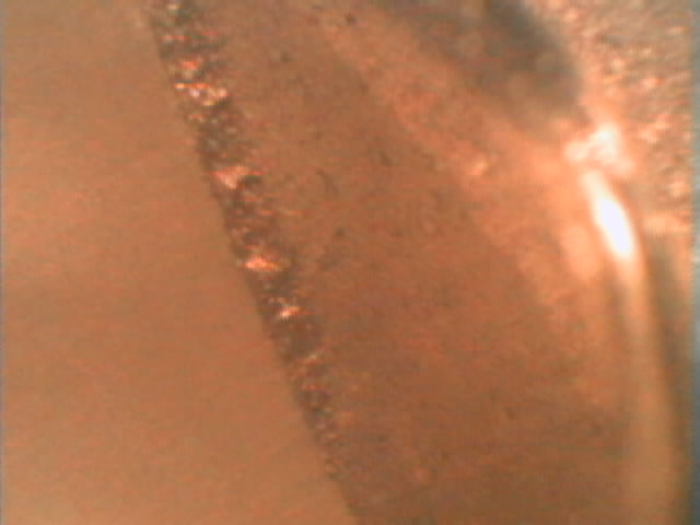

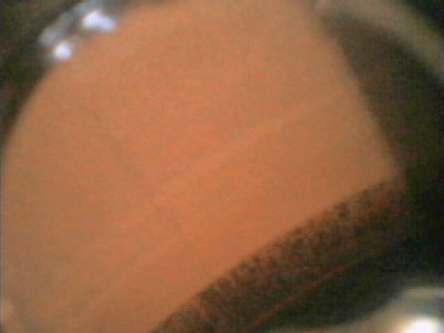

Hard to see with your pictures -- but here is a couple photos of a cracked cylinder liner to compare.
This intermixed -- especially when warm.
Also I believe this started as cylinder misfires when warm progressively getting worse.
Mike

It is hard to tell but the "crack" (I think I see) is so straight that it looks more like light scoring
