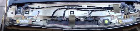

Thank you gentlemen for your input. I opened up the back but i have no clue as to what I'm looking for.I took a panoramic photo, I hope it helps.
The right hand side does the FM reception the centre (black) connector is the aerial lead in.
You may find that the co~ax cable has broken at the tailgate hinge (not usually visible as internally snapped).
You can get a repair cable which is basically a metre of cable with a "fakra" connector on 1 end, I use a company called co~star t: +44 (0)1423 340066
Cost about £5
