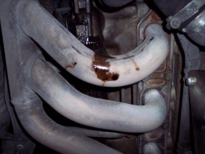

Here are two pics I took to visually explain the situation. I noticed a drop of oil on the floor of the garage but it was not in the typical RMS location. It was oil dripping just in front of the exhaust tip on the drivers side. Of course I am going to take it in but I am curious what in the world this could be? Also attached a pic of the passenger side shot of the same location and it shows a nice oil coating as well but no drip. Any thoughts?
Tighten up the 2 bolts on the cam solenoid covers. (10 mm I think) This might stop the leak. Most of these covers leak or at least sweat oil. If that does not fix it and you do not want to be raped by a dealer, clean the covers and surrounding area with gumout and wipe dry. Loosen (do not remove) the 2 bolts enough so you can pry the cover away from the block by the thickness of a quarter. Squeeze some liquid gasket between the cover and the block and very lightly tighten the 2 bolts. Wait 24 hours and make the 2 bolts nice and snug. Your leak is not permanently fixed.
The leak could also be coming by way of the spark plugs cavities due to a bad "o" ring on one of the tubes in the head.

The car is still under warranty so I will just take it to get repaired. My guess was cam cover as well. Oh well, here goes another couple days that I will be without the car. ARRGGHHH.
If it makes you feel any better, resealing the cam covers are only a few hour job. They should be able to have your car back to you by the end of the day.
I had a leak ( slow drip ). Turned out to be the oil/air separator boot which leaked. It also triggered the engine light. Boot was 30 bucks or so, labor about 600 bucks. Now all is clean and dry I may add.

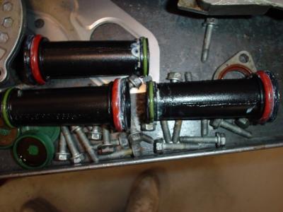

Leaking O-Rings on Spark Boots Bank 2. Whatever that means. They replaced (3) 999 707 343 40 and (3) 999 707 215 40 Rubber o-rings.
And they also cleaned all the oil that had accumulated. Now, she's all ready for the track weekend!!!

Hmm... were all the o-rings were black (instead of black and red)? If they were (all black) and they only replaced 3 of them then you may need to make another visit. This is a known problem on early MY99 engines and the TSB implied you should change them all to the new style.
Oh rats! I had no idea to check something like that. I would have to call them back and find out. It looks like thre were 6 total rings used (3 with one part number and 3 with another). My car is a 2000. Do you think I need to folow up? If so, can you direct me to the TSB so I can talk to my service guy.

1/98 1546 New O-Ring on Oil Protection Pipe (dated 5-14-98). Ask them what color the o-rings they took out were. As I said new ones are red and black.
Both... if the ones they took out are both (inside and outside) then they are the old ones and all should be replaced. If they took out red and black ones then they are the new style and then they should only replace the leaking ones.
The new ones they put in almost have to be red and black as I don't think you can get the older ones anymore.

The spark plugs are removed to replace the O-rings. I hope shops are not charging for replacing the O-rings and inspecting/replacing the spark plugs, as it takes no extra time to put in your used or new plugs. My dealer also replaces the plastic tubes at the same time because they are sometimes split, or chip when they are pulled out of the cam cover.
