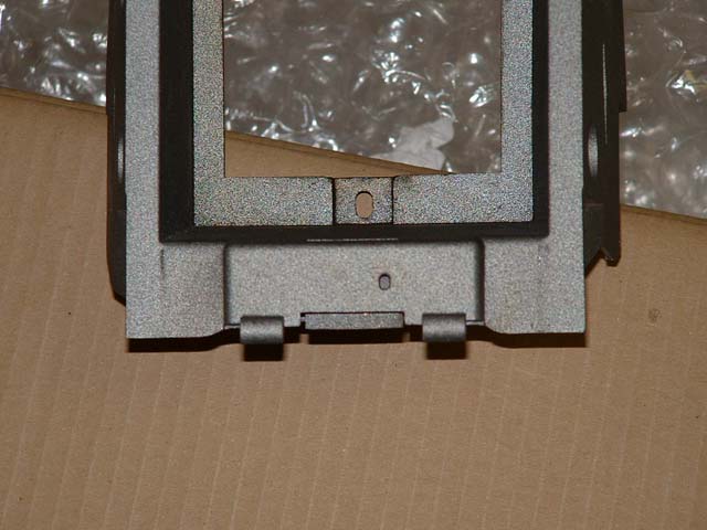

Purchased a new arctic silver center console. Everything was fine until I went to attach the armrest lid. The old console had two little 'ears' that the hinge pin slid through at the rear as shown below,

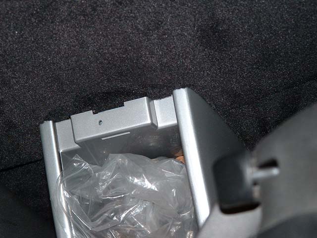

The new console has no such attachment point.
So how do I attache the armrest lid?

You will need to take ALL the hardware off the old one and mount it on the new one. That includes the little clips that hold the trim on the sides.
Actually, you will need the extra metal piece that 'creates' the hinge. The older model had a built-in plastic hinge that often broke. The retrofit kit is much more sturdy.
I was in the same boat when I did my center console. I had to order the retrofit kit to install the new hinge set. Not expensive at all. Totally worht it, much more sturdy.
