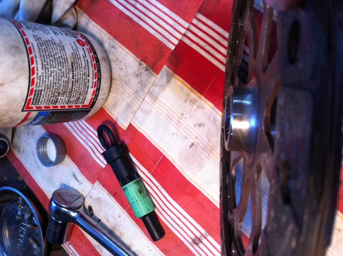

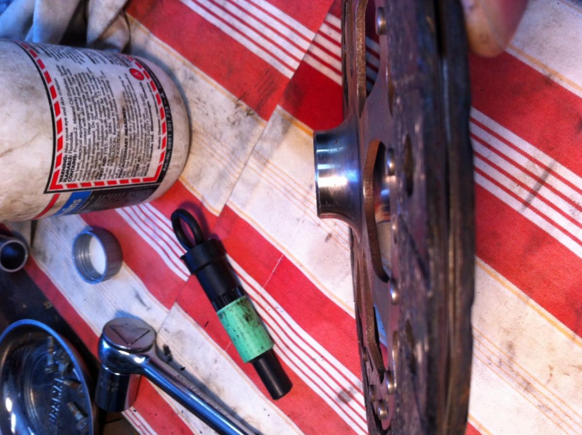

So now I am setting things up for tomorrow's main event-re installing the flywheel, clutch and trani. I kick myself for not taking pics of the dis-assembly. So I need help in determining which side of the clutch disk faces the flywheel. I think that the first pic faces the flywheel (convex portion facing outwards towards the trani) and the second pic faces the trani.Am I right?

Logray and JFP, many thanks again for all your invaluable help. Found the stamp on the disk "getriebe seite",Keep you posted. Cheers.....
