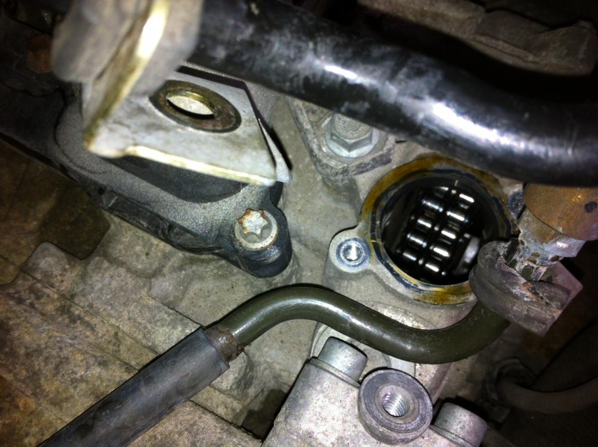

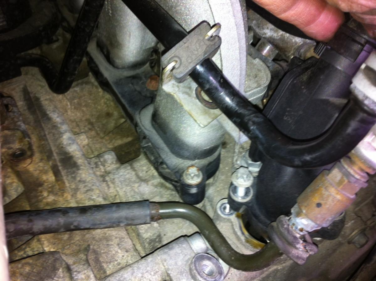

Now I really need help! The Bentleys video indicates that all three chain tensioners need to be released including the one under the A/C compressor. On the other hand, the LN instruction number 7 says to remove the IMS to crank tensioner as well as the tensioner on the cylinder head which has the locked cams. In my case I have both banks of cams and the crank already locked and I can release the tensioners on each side at the bottom of No.3 and No. 6 cylinders.
I removed the A/C compressor out of the way (which, on my 2006 C2S is not as bad as it has been written up to be) and there is no tensioner on top of Cylinder No. 4 as shown in the 997 PET-just another breather pipe over the right bank sprocket. See pics: So where is the third tensioner???? Has it been moved to underneath the power steering pump or the alternator.???? I want to finish this project this weekend so any help would be appreciated.

1. You can leave the bank 2 tensioner in (most people do). You should be fine to proceed. As long as :
The engine is pinned at TDC
Both sets of cams are locked
The bank 1 and IMS tensioners are removed
If you find it impossible to insert the new flange afterwards, then you'll need to remove the third tensioner as well.
2. Yes you can remove just the three compressor bolts and it comes right out, then you can access the third tensioner. The rear compressor bolt is easier to access when you remove the throttle body and T-plenum behind it. Then reach around with your left hand so you can feel where the socket goes in from the top between the intake plenum.
Edited by logray
The 4-6 bank 2 tensioner has an allen/hex head and a flat top, unlike the other two tensioners. (12MM IIRC?) It is right under the power steering pipe in your picture.
Edited by logray
