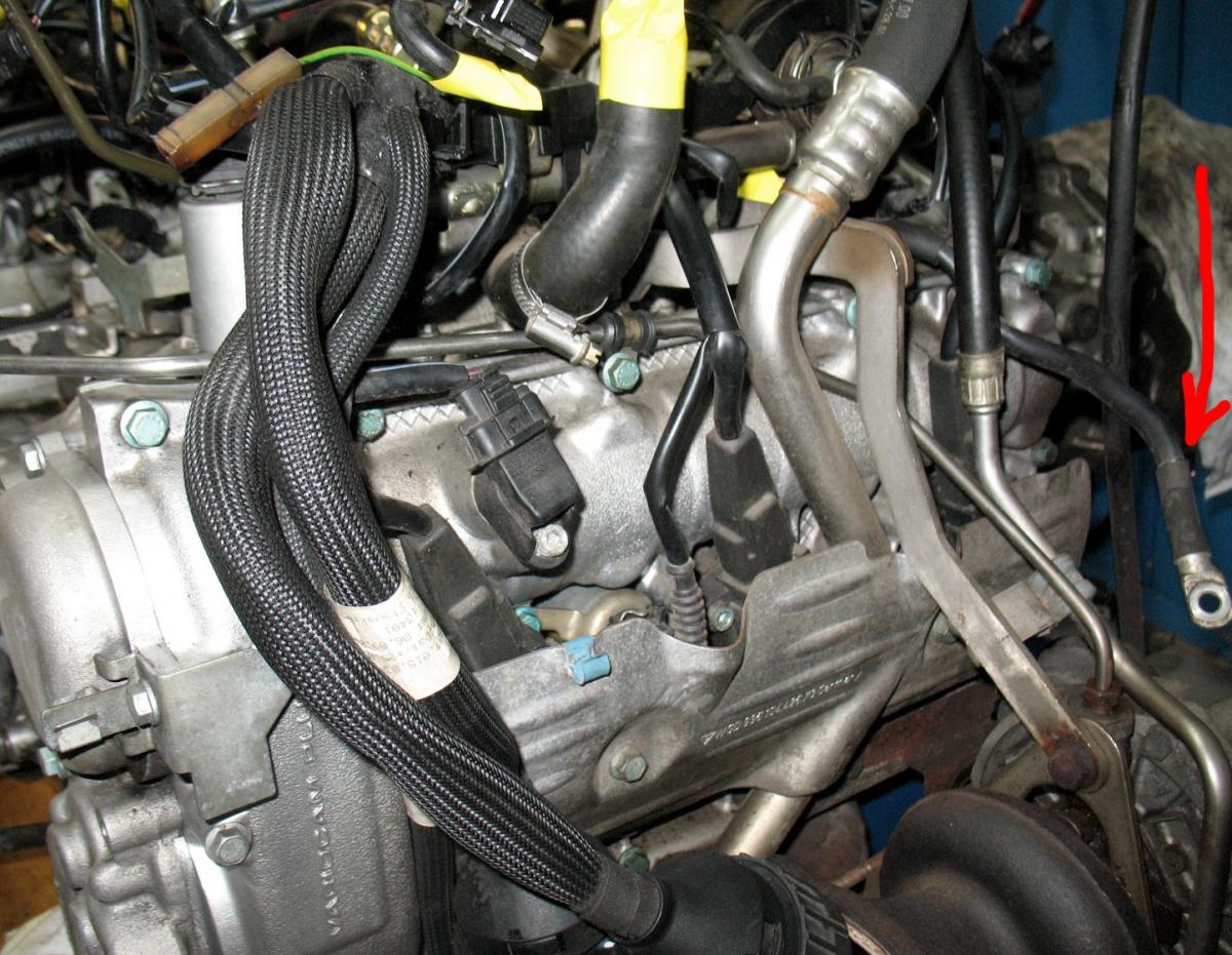

JP, Does the ground strap have a bolt securing it on both ends? If so, how difficult is the engine side to access? I can see where the outside end mounts on the frame from some pictures I took with the engine out..looks easy to inspect that end.

In fact John, it is secure to the body with a bolt (need to be removed when removing the engine) and the other end, I am not sure and cannot see it on all the pictures I took...I have found one picture of the ground when my engine was out. Hope this help.

Just found a picture in my collection of TT pics and the other end of the ground wire is only a bolt to the engine block just aft of the engine oil reservoir. It must be difficult to reach because it is in front or the air pump.....

Thanks, JP - just the picture I was looking for! From most of the advice I have received, a rapidly clicking starter is not the starter clicking, but rather the solenoid and it usually indicates it is not receiving enough electricity to fully engage, often from a loose or corroded connection. I have decided to take the car in for testing and see what we find...
Now I know what to look for, should the ground strap require replacement.

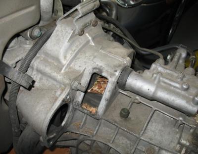

Thanks for your help everyone! It ended up being that a mouse was eating the wiring, which lead to the failure of power to reach the starter! That explains everything...

It is because you don't feed them John. Mine were having birds seeds from a bag in the corner of the garage and rest after a good lunch in the bell housing !!!!
