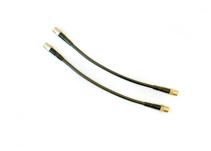

We are at "cross terms" here, the line going to the caliper is a "flex" line, the "hard" lines are attached the chassis. The caliper flex lines look like this:
The hard line connection you can see if the photo I provided, and looks like this up close:
On some cars, the flex line goes direct to the caliper, on others there is a short section of hard line at the caliper that is connected to a flex line that runs up to the main hard line. I have to assume that is what you are referring to....
If you are just changing calipers, no plug is needed as long as the lines are not left open. But in any case, you are still going to need a fitting wrench to get the caliper apart.
