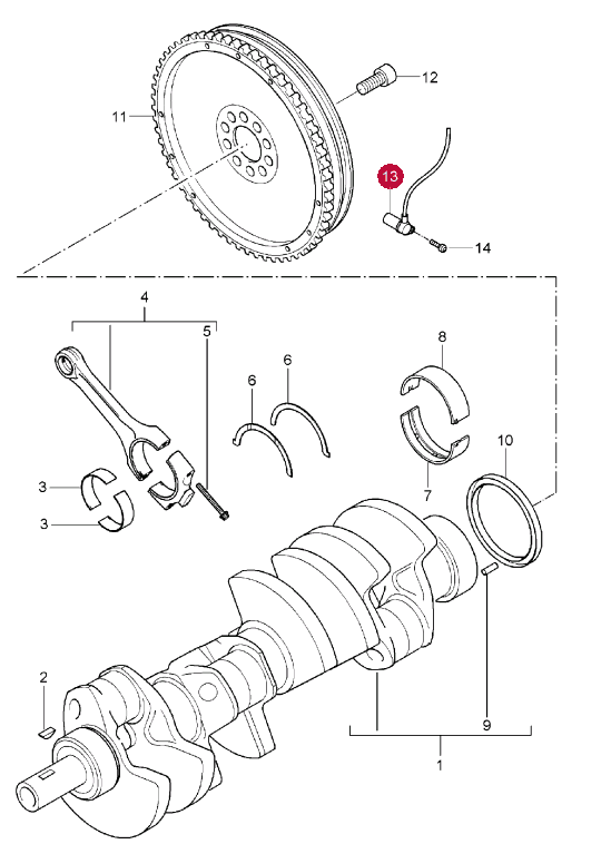

Would anyone be able to tell me where to look for the crankshaft sensor on a 955 cayenne turbo. I looked around the bell housing and found a sensor that looks like it on the undersurface on the drivers side and actually quite easy to get to but I wanted to make sure that there are not other sensors that are around there as well. I only need to find out where to other end goes for the connector. I have a picture of it but don't know how I can upload it to the site to look at.

It really is the only one that sits on the bell housing facing the flywheel.

The crankshaft position sensor in a cayenne turbo is actually pretty easy to change. If you get up under the car, you will find it attached to the bell housing on the drivers side on its inferior side. The exhaust pipe runs nearby. You will see its wire run straight up and its connection is located right behind the SAI on the drivers side.
