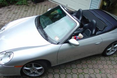

fpb111;A bit off this present topic but while we are waiting for Monsieur Garwood74 to fill us in on his repair, I have never seen a 'Metropol blue' interior with AS as you have. Would you mind sending us a picture of your interior if that's not too demanding? Is this a color that is only avail in a cab 911? Thanks very much!Garwood74;Comment ça va?Martin

Garwood74: Félicitations pour ta besogne d'AOS, Simon! Oui et non à ta question! My pleasure to tell you more some other times. On such a cold day like today in Montréal, it is nice to live on the rainy West Coast (+5C today). Back to the AOS, if you can take the time to explain a bit more on the approach you took to do this job, it would benefit a few of us in the near future. As my C2 is approaching 90K miles (143k kms at this time), I'm pretty sure it is still the original AOS. The fact that my drive-to-work commute is not very long, likely doesn't help either on the AOS department. So far so good, though!At the present time, I'm dealing with a pass. inner door latch replacement (window not coming down and interior lights not coming on when pass. door open) and a speaker board that is falling apart due to a vapour barrier (liner between door metal & door panel) that was badly damaged by a previous owner's not so brilliant work: board and speaker have to be replaced as well due to corrosion.fpb111: Many thanks for posting these pictures. This metropol blue goes well with Arctic Silver, I must say and rare to boot. Nice aerial shot of Teddy at the helm! Cheers!
