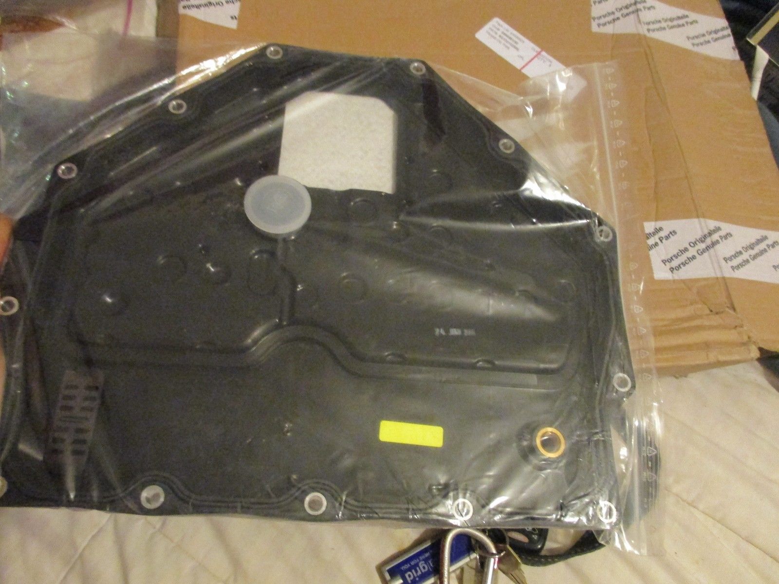

The part in the picture you gave the link to is a replacement transmission pan (Porsche part number 9G131202500) which retails in the US for $305  http://www.sunsetporscheparts.com/porsche/911/9g132102500/2009-year/carrera-trim/3-6l-h6-gas-engine/maintenance-and-lubrication-cat/transmission-components-scat/?part_name=trans-pan  The pan itself contains a filter element which is not serviced separately. It filters the clutch oil, the gear box oil is not filtered.
My car is 6 years old and want to replace the PDK clutch oil.
To replace the oil filter - the whole pan should be replaced.
Is this pan serves clutches compartment only?
Visually it looks to me like it covers the gearbox/cogs part - if it's true than gearbox/cogs oil also has to be changed.
So what's the situation with it?

The pan in the photo mounts on the bottom of the gear box, but contains the clutch oil filter (gear box is not filtered). Removing the pan does drain the gear box.  In order to change your clutch oil, you need access to a PIWIS unit during the process; it is not a simple drain and refill.
So to get PDK clutches oil filter replaced - there is a need it to replace a pan of the gearbox - which leads to replacing gearbox oil too - correct?

Like the Tiptronic before it, the PDK can benefit from early service.  The clutch oil becomes fouled with solid debris from the wet clutch packs, which the filter removes.  And like any filter, the more it filters out, the less it flows.

The gear oil drain plug is in the transmission (plastic) pan. and the gear oil fill plug is on the same side, a few inches up on the case. Both plugs are hex head and a little larger than clutch oil fill plug. The clutch oil drain plug is on the tranny pan. and the fill plug is on opposite side as gear oil fill plug.
