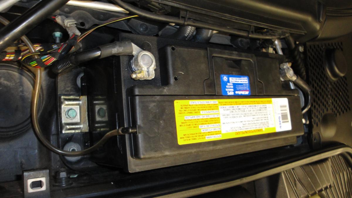

I did the same. A little extra weight was not a concern, so installed the largest battery that would fit. I used the last hole for the mount and as Chuck and fpb said, you can hold a nut under the tray from the end.
post-85078-0-18860900-1356924002_thumb.j
