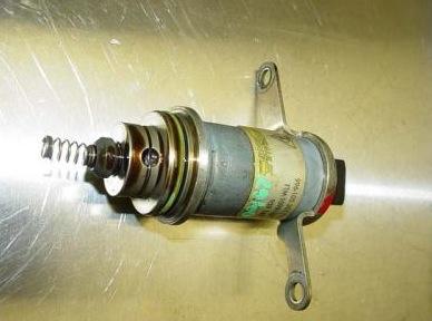

Did you look at the bracket on the valve lifter solenoid. If you already replaced the coils and plugs the OBDII manual is talking about valve lift. May be one of the solenoid is not in position due to a fail bracket....
Edited by jpflip
Or a stuck valve lifter on cyl. 5, ( only for variocam+ engines ), lifter remains in the full lift possition.
Going to check bracket. What about solenoid itself? Replace out of caution at same time as bracket?
They don't fail often. Just the bracket should be fine.... If you have durametric it is possible to trigger this function and see if it is working properly.

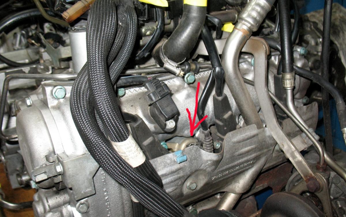

Sorry. no easy way...It is hidden behind the heat shield....
