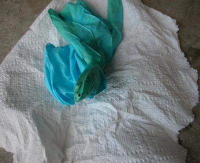

After an oil change I inspected the oil filter and found a few black fragments apparently made of plastic in it. I collected most of them on the glove that can be seen in the attached picture. This is the first time that I see these fragments in an oil flter. There was no metal in the filter. Is it possible that the fragments come from the seal of the IMS bearing that has started deteriorating? If so, how could this be confirmed without removing the bearing from the engine?

There are several possible sources of small plastic bits, including sealant, cam tensioner paddle wear pads, seals, etc. The most common are the wear pads (black or brownish) and sealant (brown or green). There is no way to confirm the seal condition of the IMS without pulling the trans, clutch, and flywheel out and then pulling the IMS cover after locking the engine down; and at that point you may as well just replace it with the LN unit.
I would not be overly concerned about the few bits you have, this is a fairly common find during an oil change.

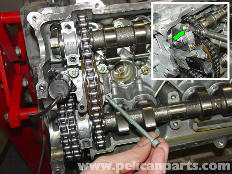

Hard to tell without actually seeing them, but as I mentioned above, the most common sources are the wear pads on the chain paddles.  As your son's car is a five chain motor, they are probably from the small wear pads between the cams on the cylinder heads, which are easier and cheaper to replace when the time comes.

The small chain paddles can be done with the engine is the car, although it is a bit fiddly to do as the cam covers have to come off.  You might want to ask the shop doing your IMS if they can put together a "packaged deal" for you to do both if it is required, as it could be more economical to address both at the same time rather than taking the car apart twice.

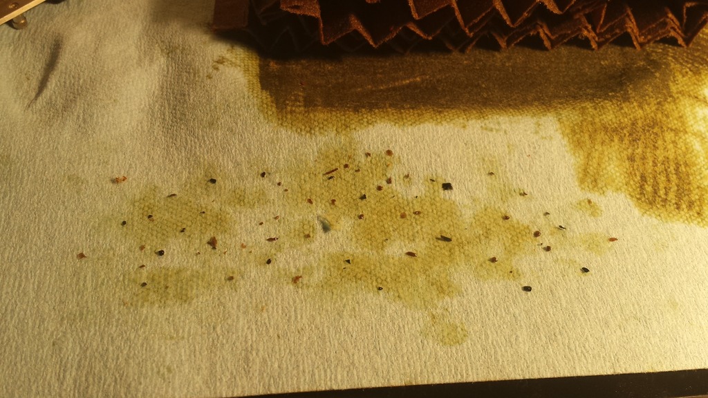

To add a little color to the thread, here is a pic I snapped last night while digging through the filter.

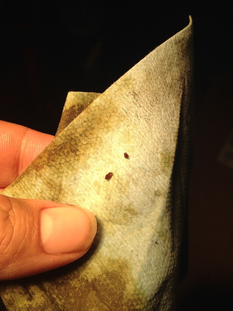

So cut open the filter and found both brown and black small pieces (pics below).  Cam deviation values will be checked within a couple weeks.  Main question I'm now contemplating is will I be able to drive the car a few times until then.
If none of the specs are ferrous, you should be alright; if the cam deviation values get too far out of line, the car would code before anything happens.
