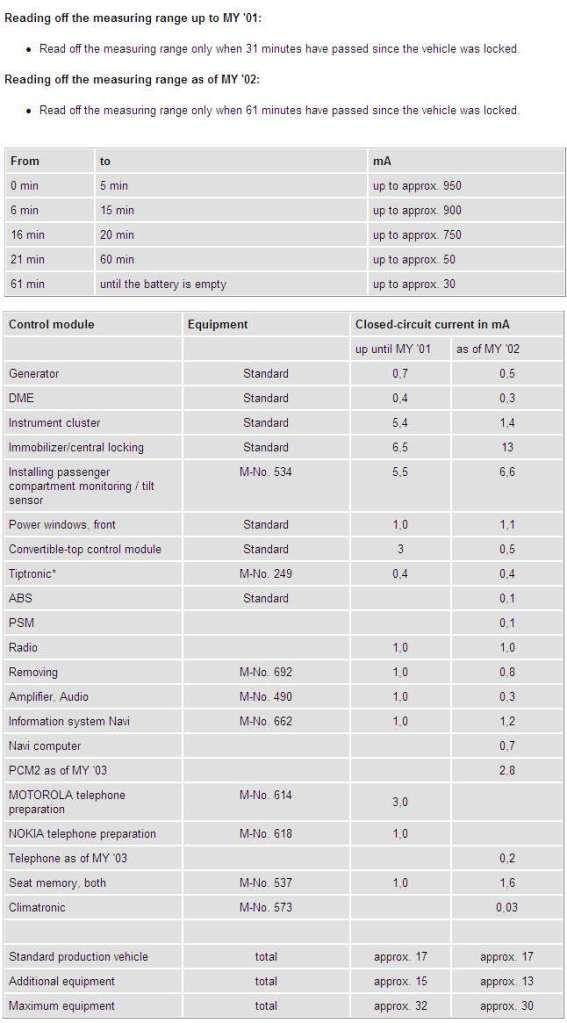

Does anybody know how much current you should see from the battery, with a digital amp meter in line, when the car is off, with the key out of the ignition ?

When the system has settled (everything has switched off after about 1 hour), you should see 40-60 mA. Here's a list of what various systems draw when active, and the typical current draw vs. time:

If you leave the car unlocked, it will drain the battery in that state more quickly than if you lock the car with the remote.
