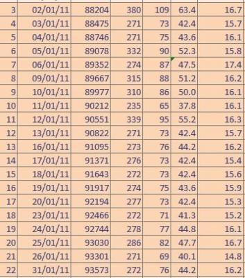

Same trip to work every day all highway at around 140kph in GTS (left) 05 turbo (right) last column is litres/100 km
