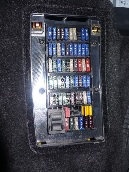

My Mac i-tunes didn't have an "audio" burn, so with your info I downloaded a Mac audio CD burn, it worked... Many thanks for your direction and help. Another question, what is the ORVR fuse (fuse E6) for? E7 fuse is for "info" and "telephone", I don't have a telephone accessory so do you need this fuse? Is this "info" for the telephone only or does it support some other functions?
Thanks again for all of your help...
ORVR = The system recovers the vapors let out of you gas tank when you fill up your car. It only works when you fill up your car and insert the nozzle into the filler neck. When you take off your cap, push in the flap and you should hear a click for the system to start.
All US/Canada cars got "Telephone Prep" so your car has a cable under the center of the dash console that has +12 volts switched, +12 volts un-switched, Mute, and Ground.
"Info" usually refers to navigation systems like PCM (and some PCM systems also supported telephone).
Thanks Loren, again and again... I was trying to weed out the in-opt accessories fuses, maybe this isn't really needed?
