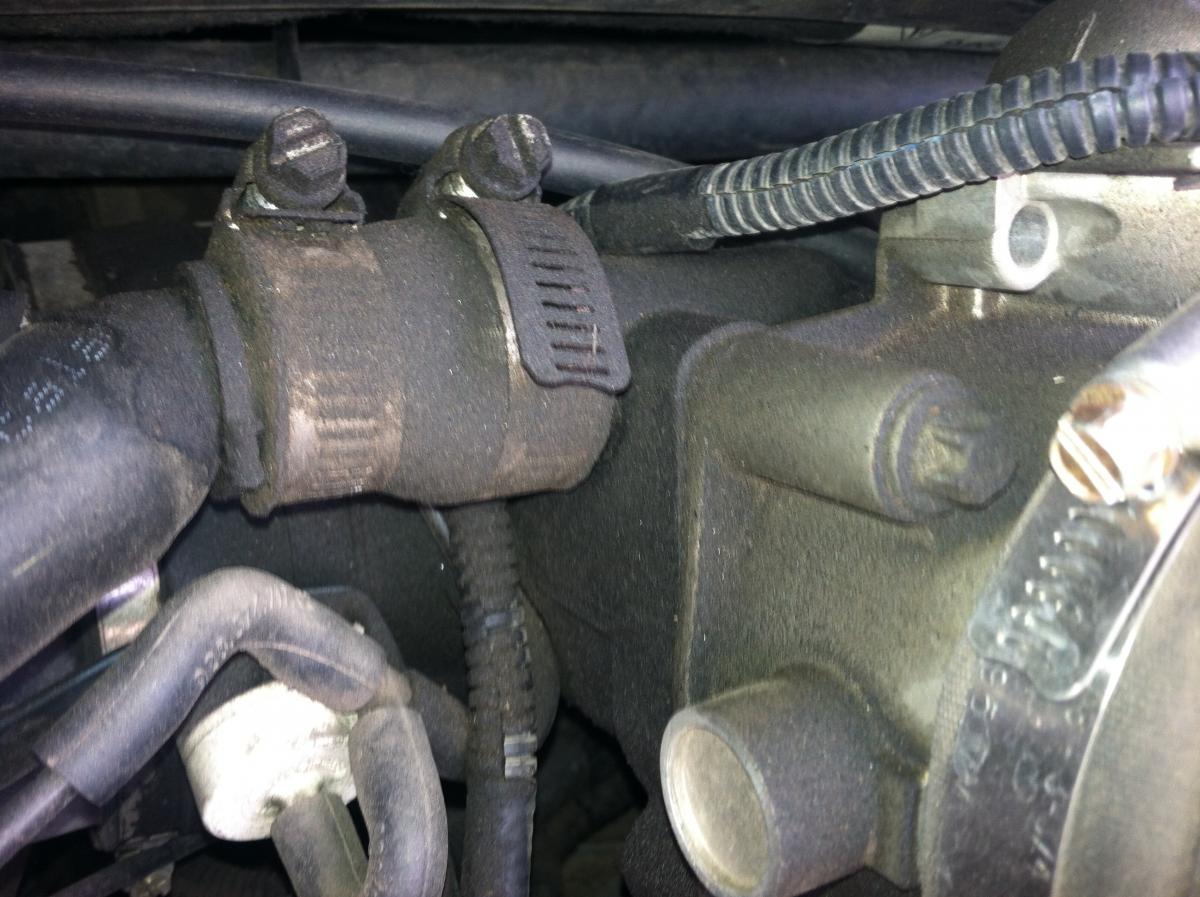

Any suggestions why there is oil residue around the throttle body area; its on top and on the right hand sdie also; I have checked fittings and everything seems tight; it can barely hold an idle in moringing when cold.
Going to take intake pipe to throttle off and clean; maybe that will help with the issue on start up.
Thanks for any suggestions

The piece of rubber hose with the two hose clamps is not OEM. It looks like something broke and this was a repair. That might be the cause of some oil residue.
I did have a turbo kit on it and had it removed; checked the clamps and all tight; maybe I should pressure wash off engine and see where it develops again??
Do not "pressure wash" the engine! All kinds of bad things will happen from there...way too many electronics in there. Why not just wipe that down with some clean rags and maybe a little WD-40 to clean things up a bit and then watch it over time to see if any thing develops. Sounds like you have a small vacuum leak and I agree, that rubber hose fitting is not OEM. I would start right there.
