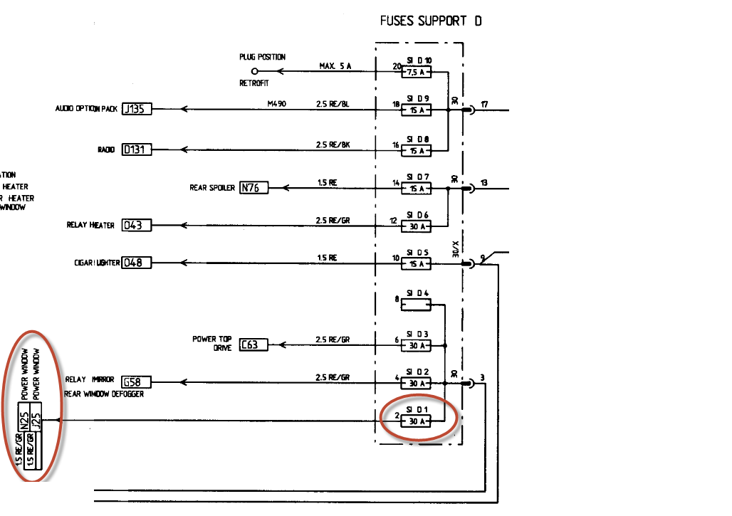

There is no difference between MY2000 and MY2000 S. D1 (30A) is the correct fuse. Have the switches been removed and reinstalled with the white and black harnesses reversed? White goes on driver's side. Any other electrical gremlins? A failing or faulty ignition switch can cause some unexplainable problems. You can try jiggling the key. My headlights would intermittently fail when my ignition switch was failing.

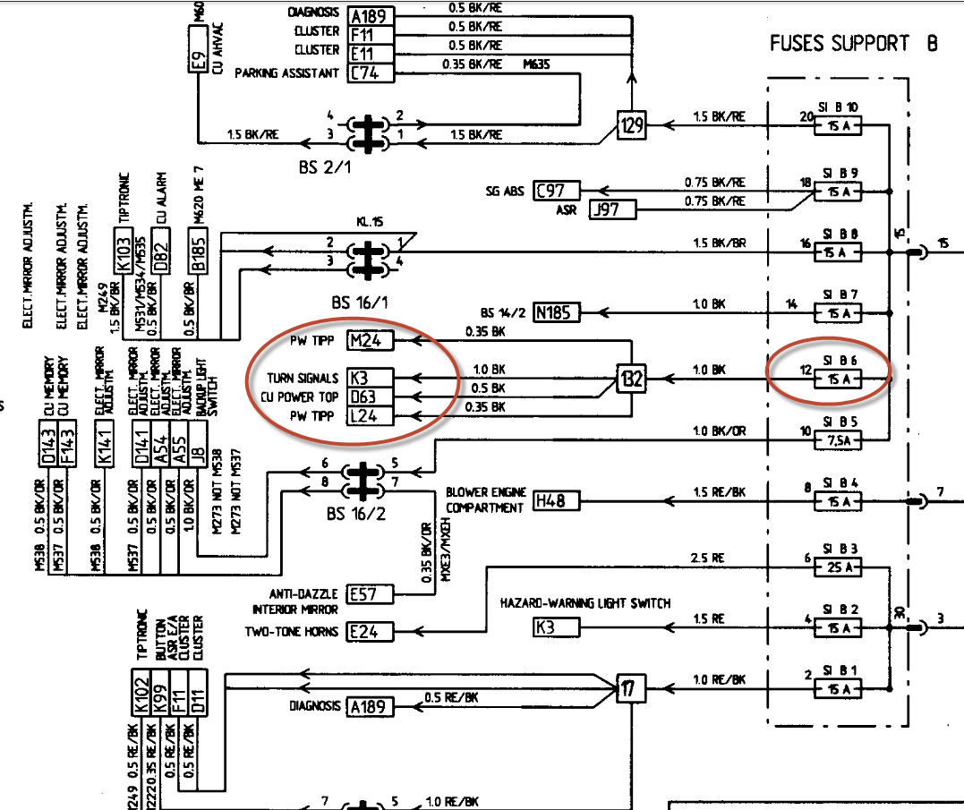

Just to be clear... so others are not confused.
If you look at the power supply schematic (and you read the schematic) you will see that the power windows are on D1 not B6.
B Fuse block on power supply schematic
D Fuse block on power supply schematic
thanks for the diagrams Loren!
D1's obviously the main window motor fuse. However, the fuse block label in my car definitely calls out A6 for the windows as well. On your pic of the B-block. the 6 fuse protects two identical components that are shown as "PW TIPP". It's my guess that PW must stand for "power window". I wonder what TIPP is?
