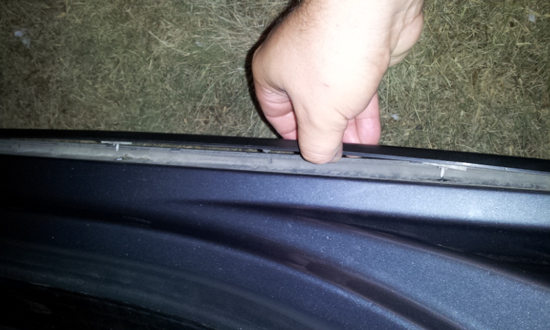

I need part number of the fasteners that hold the trim piece (dark plastic going down bottom side of front door, on outside). You can see the trim when you open the front door, then look down on outside of door opening, where bottom of door meets the chassis of car. There is a small plastic piece, dark, which is heldby white plastic fasteners (inside of the trim). If you pull the trim and twist up a bit, you can see the fasteners (I need the part number for those white fasteners). See pic.

Item 3 -- 955-559-547-00 Clip mount door sill rail (front and rear) -- US MSRP $0.69 each
You may also need 955-559-586-00 Grommet mount strip door seal (front and rear) -- US MSRP $0.69 each

Can anyone tell me what the difference is between 6 and 9?  Are these grommets needed in order for 3 to hold snugly in place?
They are the same part number.
32 total used per one car - mainly as mounting for door seals, and fenders.
It looks like these grommets are what I need for the trim to "snap" into place.  Right now, the body of the car does not have the grommets. The diamond shaped hole where #3 would normally snap in is currently too big.
