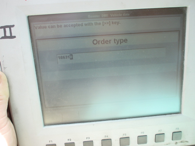

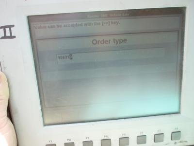

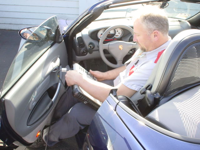

2003 is no different than a 2004. Peter at my dealer has turned on a 2004. He is the one who figured out how to turn on a 2003. 2003 was different than the prior years because the PST2 was searching for something, and that something was missing. What was missing for some strange reason was the model number for the car. Once the model number was entered then you could change the coding of the instrument cluster to activate the OBC.
The first picture is the first 2003 my dealer got, and the computer is being turned on.
The second is another 2003 with the model number being entered. 986310 is the model number for the base Boxster, and that is what was missing.
I did the OBC retrofit on both cars. The owners bought the stalk unit, wires, and connector. Nothing else.
