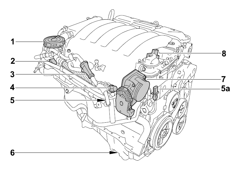

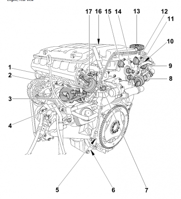

DOH!! 2005 - V6, those numbered diagrams are fantastic, but cannot tell what part is what just based on the number. Looking to locate the PVC valve. Think I know which one it is, but just want to verify. Got the dreaded P2187, 2189 codes too.
Looking from the front...
1 - Positive crankcase ventilation
2 - Secondary air valve - mechanical
3 - Sucking jet pump
4 - Positive crankcase ventilation heater
5 - Hall sensor (hidden)
5a - Hall sensor connector
6 - Oil level and temperature sensor (hidden)
7 - Throttle adjusting unit
8 - Bar ignition module - cylinder 1 (Bar ignition module 2 to 6 hidden)
Looking from the rear...
1 - Variable-length manifold - mechanical
2 - Secondary-air solenoid valve
3 - Vacuum accumulator
4 - Solenoid valve for variable-length manifold
5 - Crankshaft sensor (hidden)
7 - Coolant temperature sensor
8 - Additional water pump
9 - Tank vent valve
10 - Secondary air valve (hidden)
11 - VarioCam solenoid valve, exhaust camshaft
12 - Exhaust camshaft hall sensor
13 - Positive crankcase ventilation
14 - VarioCam solenoid valve, inlet camshaft
15 - Inlet camshaft hall sensor
16 - Positive crankcase ventilation heater
17 - Fuel injector 6 (Fuel injector 1 to 5 hidden)
