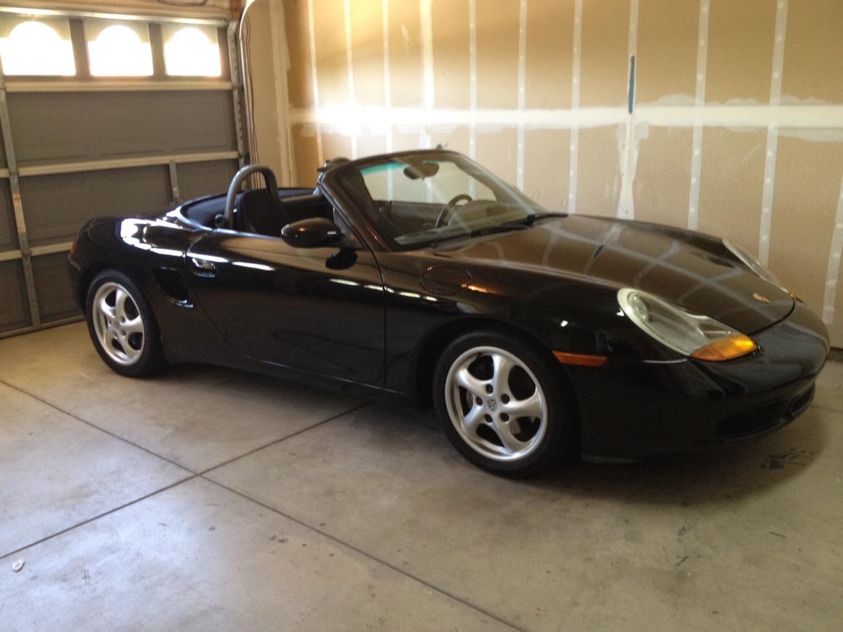

So the other night I was talked into letting my girlfriends brother drive my 99 boxster 2.5l. To say the least, im preatty sure he burned up my clutch. I could smell it and I could tell by the way he was letting it out so slowly. Well when I got back in the driver's seat I realized the car seemed to be shuttering or hesitating whenever i would give it more than minimal gas needed for acceleration. Usually it happens right around 3k rpms. I was assuming that it was the clutch starting to go.. I looked around on pelican and some other forums and would probably end up doing the clutch myself if it came to it. But I guess Im just wondering if there is something else that may be going on? Does something need to be adjusted? Replaced? Any help or pointers are greatly appreciated.
99 Boxster Base
97k Miles
2.7 liter 5 Speed
