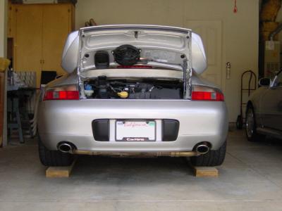

For oil changes you don't even need ramps. I use 2 x 10s -  three per side.
More than enough clearance.

Do you lift the car and set the boards under it or do you drive the car over the boards?

I drove on the boards (backed on in this pic). The bottom board is about 6 inches longer than middle board which is about 6 inches longer that the top board. So there is a stair steep effect.

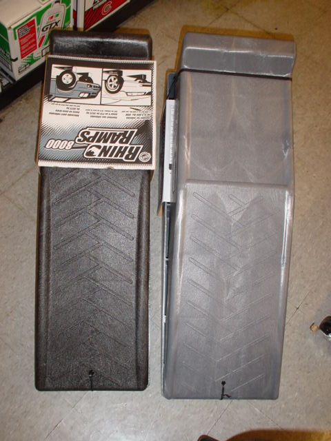

You can try those plastic low profile rhino ramps. There are now 2 types according to weight ratings. Good if you have a sloped driveway since the engine will be level.
Loren,
A question that I can't answer by staring at your picture. Are the 2x10 ramps full length, i.e. under both front and rear wheels?
If not, do they leave the car level enough for adeqate oil drain?
Kim,
No they aren't. But they could be. This only adds about 3 inches so it is not like jacking the car up a foot or two. If you really want level then just put them under all four tires.
