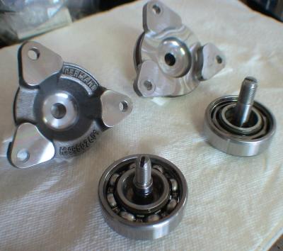

I recently had a LNE installation that went wrong, the post in the middle fell out upon installation on a 2002 Boxster S.

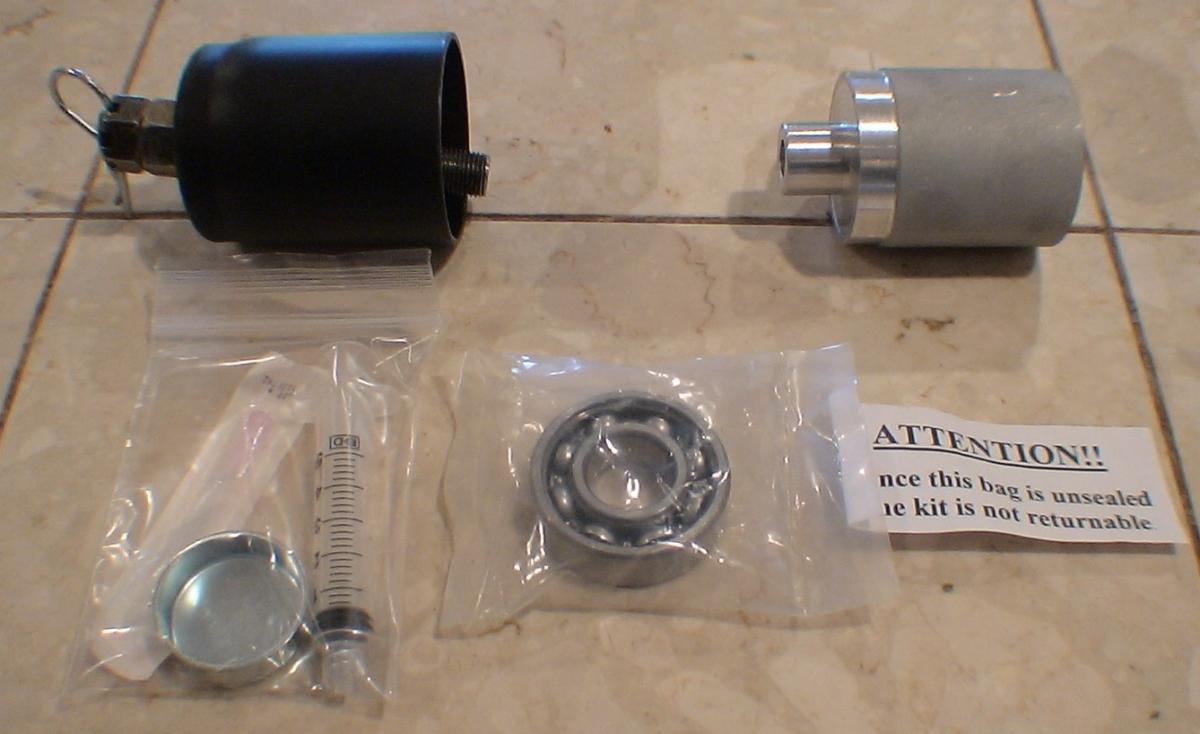

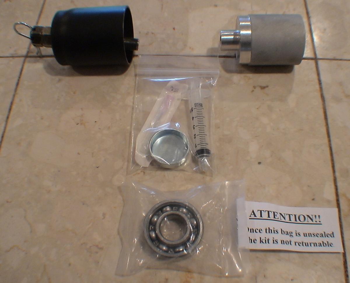

I found out about Casper Labs from a friend and they set me up with, I believe, better install/removal tools AND a better bearing. Apparently, they are FULL CERAMIC bearings, not just coated ceramic. They should outlast my vehicle (100,000 miles). The installation was slightly easier but what I DID NOTICE was - the bearing was noticeably smoother and 'slicker'.
Here is a Youtube video I made of BOTH bearings side-by-side. This is not a scientific test BUT IT IS EYE opening if you are in the market for an IMS:
Also, the installation on the Casper has an added benefit, the cap. You place a cap inside the IMS Shaft and that keeps debris from forming AND keeps the bearing a little better oiled. Not that it needs much. In fact, these bearings run in industrial applications that have NO OIL. The removal tool weighs just a couple pounds - not 9lbs.! The install tool is made of ceramic so it does not deform when you strike it. The instructions for the Casper bearing were FAR MORE DETAILED!
Will give you an update as the miles roll by but this may be the first time these 2 bearings have been seen together.
Did LNE stop selling their IMS bearings? LNE are no longer selling form their website.

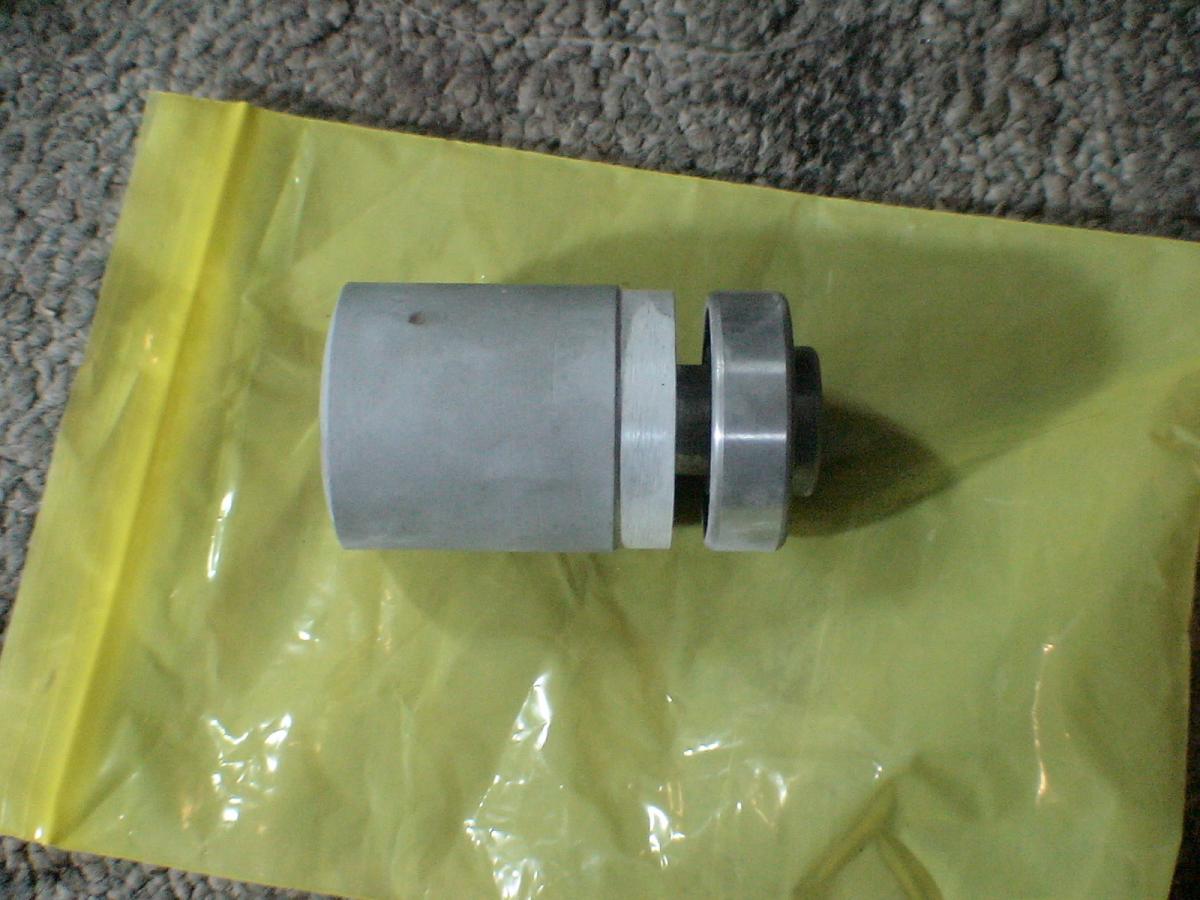

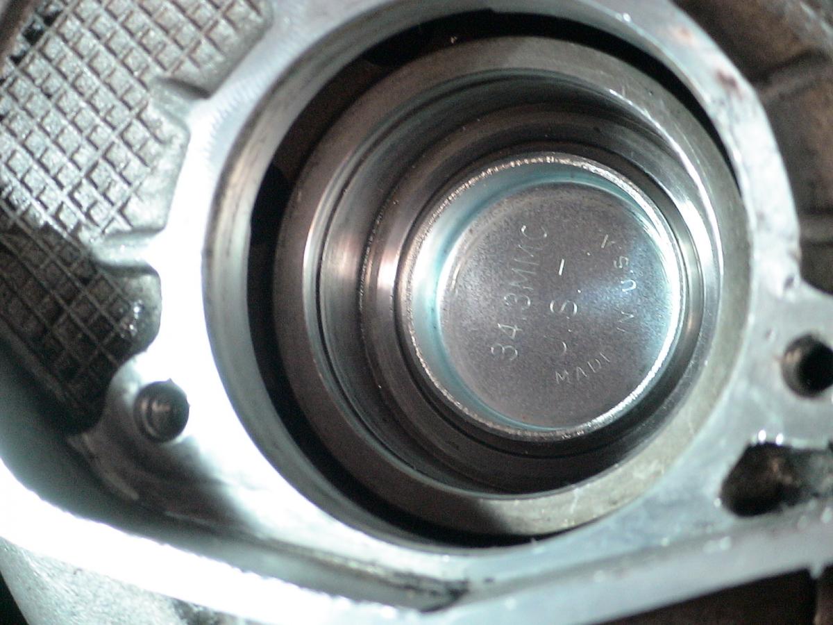

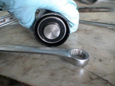

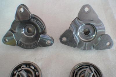

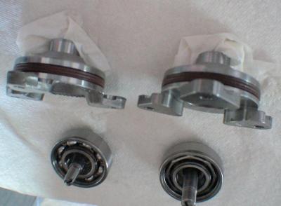

Here are some comparison pic too…since I was one of the first to have BOTH - here are the results!
The Casper Labs bearing is on the left, LNE on the right.

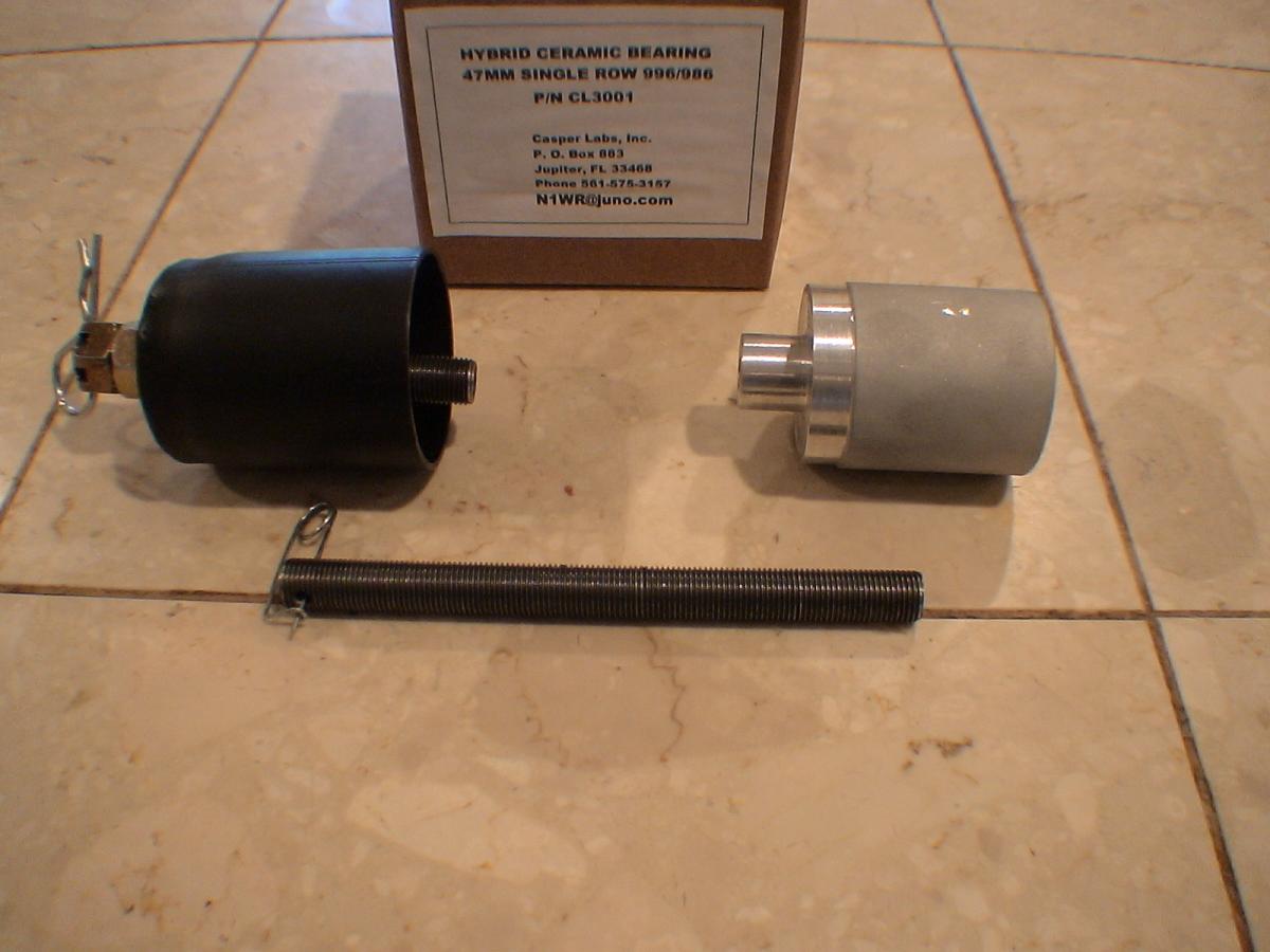

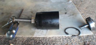

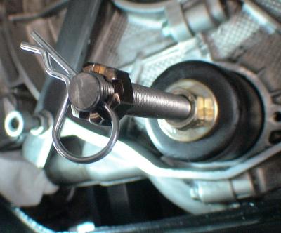

Pics of the Casper Labs Installation tools?

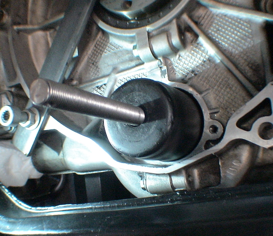

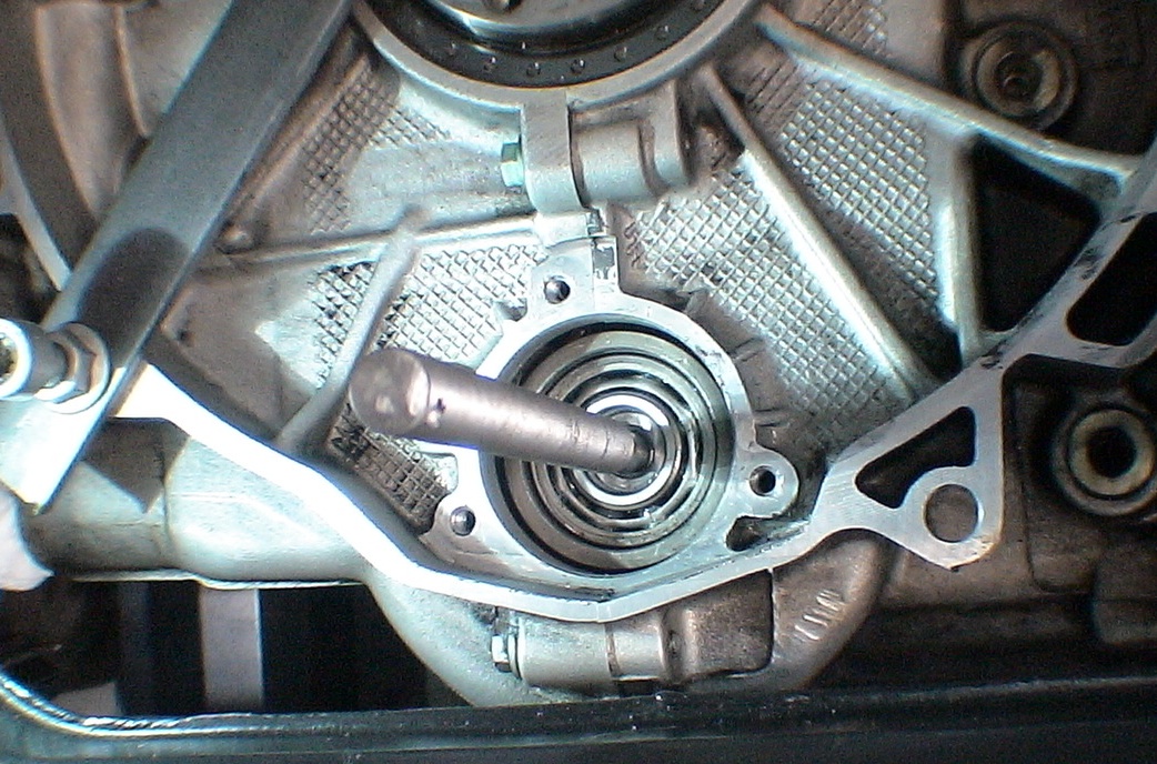

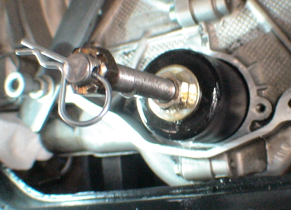

The Casper extractor is sweet! Not anything like LNs…so much lighter and easier to use AND it has a locking nut with a cotter pin to ensure that it locks in place. So when it is ready to do the business, it is just a few easy turns and you're done. He even made me a special tool (for only $10) that will REMOVE LNE's IMS bearings.
You see, LNE uses a 'standard' (as in 'not metric') size center bolt and nut, it is larger and thicker but could be a reason why there are some that are leaking, and that is why installation recommends using Curtil (?) sealant. Of course, the Casper IMS re-uses the Porsche IMS Center Post, you pop it out of the IMS bearing (it cannot be ordered separately using the PET system) and replace the o-ring, make sure it is good and you are ready. Just stating the facts since I HAVE USED BOTH. The IMS cover is also Porsche Factory and is put on "dry".
I did not have confidence in my LNE bearing when the center post 'popped out' during installation. I called LN and they insulted my intelligence and mechanical ability. So, I ordered the Casper and have not looked back. Besides, in case you haven't seen the video, the Casper rolls MUCH BETTER...right out of the box. After oiling, it is even more slippery. In fact, the only problem I had putting it in…was trying to keep it from rolling while I was tightening it down! BTW, this bearing should outlast your car at around 100k+ mileage expectation. No more replacement at every clutch.
My LNE bearing part number is 66??….so they have sold a lot. And while the Casper sells for only $323 (for FULL CERAMIC IMS Bearing, IMS Shaft Cap-another cool feature, Syringe and VERY DETAILED instructions) AND it appears, although I'm not a Bearing Scientist, to be better all the way around! The experience with Bill was certainly better than the whole LNE deal. The tool kit (extractor, install tool) is ONLY $83!! Compare that to over twice the price for LNE's tools. Basically, the Casper is a FULL Ceramic IMS Bearing FOR THE SAME OR LESS THAN A STOCK BEARING!
What else could you want? No, I'm not putting it in for you but I have done your homework! I will try to post more pics.
